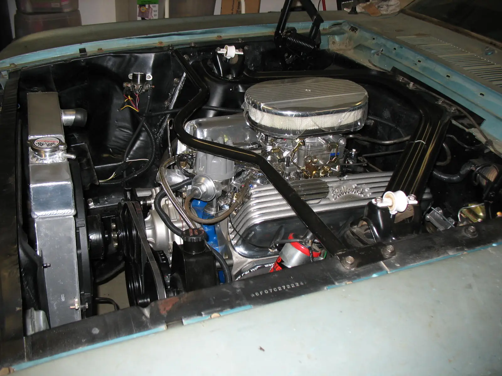

my new 3 core radiator and fan combo hit my waterpump serpentine setup...is there a different approach to this ,put fan on both sides problems in both areas...does someone have the magical answer..or is it time to get out the torch! thanks for everything

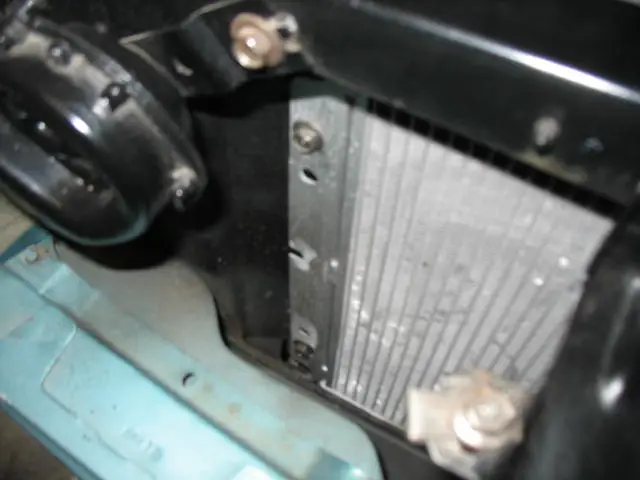

I had to do as Loup-garou said when I put the 3 core in mine. I didn't need much, so just moving to the front of the support worked for me. I used a cut off wheel to remove a section of the curved part top and bottom. Flipped the clip nuts over and was good to go. Pictures aren't real great, but they may help show what I did. IMG_1967.webp IMG_1792.webp
another option (involves cutting), is getting rid of the raised area so the radiator sits flush with the core support. I did this to open up the front end (expose more radiator), and give me the needed clearance. I also used the Ron Morris mounts and slid the motor back some.
