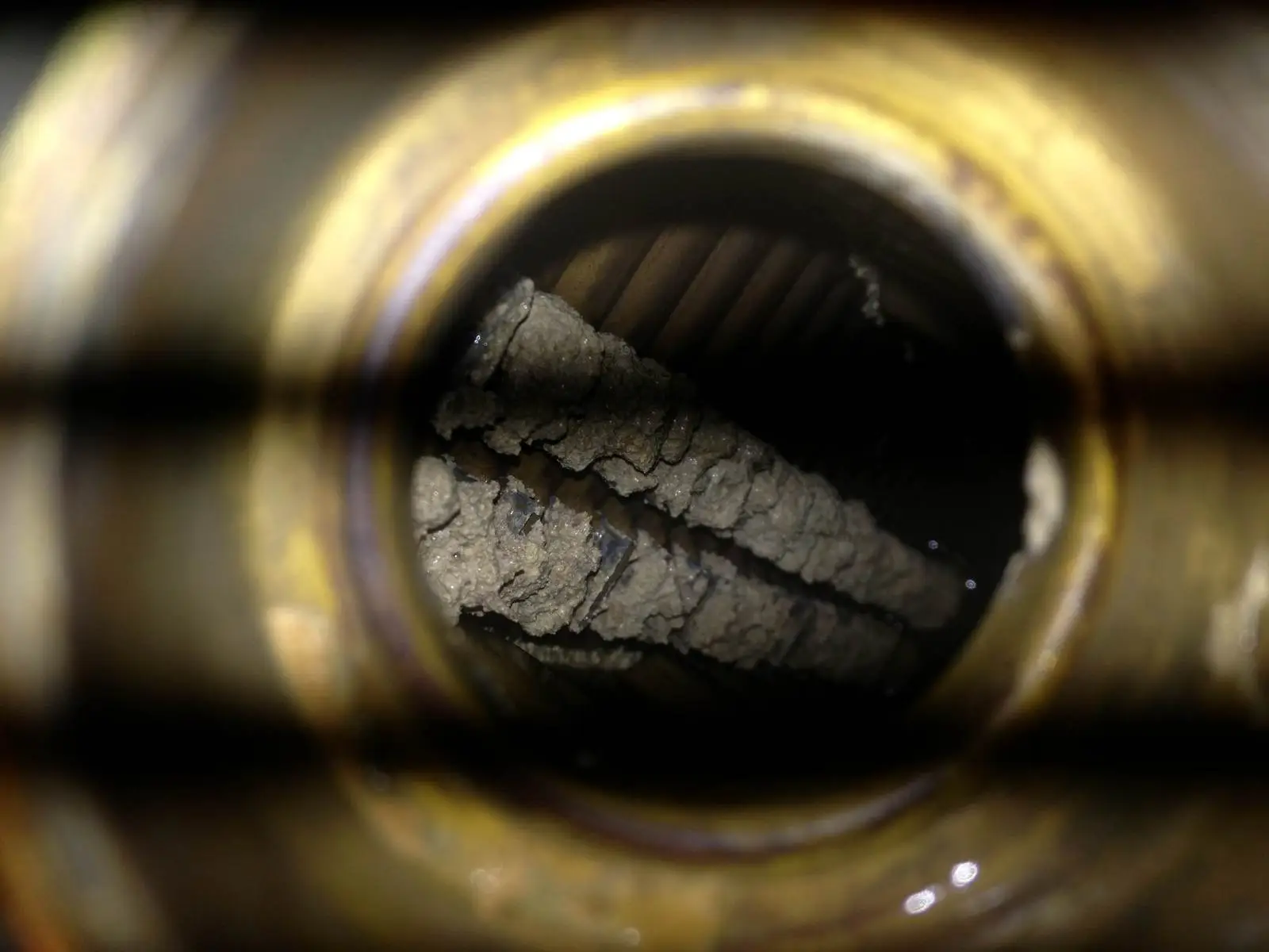

I just bought a beautiful 89 fox with the 2.3, I have been doing routine things to the car and found some misinformed person put stop leak in the cooling system and my radiator has a ton of white crusty residue in it.
Should I,
Replace with universal that they sell at Pep Boys (fitting problems?) ($60 I have an account) Has anyone done this successfully?
Have a radiator shop clean it out, ($85)
or Buy a direct fit American Muscle, Late Model (around $200)
What do you guys think?

Its an older all aluminum/copper sucker 25 years on a radiator has not been well to it, I have a manual so I don't have to worry about the trans. The cheapo seemed to not fit well inside the engine bay, kept having trouble with placement so I'm taking it back, currently I have a shop testing the sucker to see how well it cools, I'll know more then. Seeing what other people would do/have done.
White crusty residue sounds like electrolysis from not flushing and changing the coolant or running just water, especially hard tap water. I have seen a radiator have so much of the silver powder and brown stuff that part of it and the heater core were clogged. It did not look like you describe. But the silver stuff should not make crusty deposits.

Radiator shop told me they see that sometimes and its an excessive amount of stop leak. You're right IF I could clean it, it would have leaked. I tried 5 different flushes and it still looked like that and I had it tested(for free), they said R.I.P. :eek:

Plug it up at every end, add a couple of bottles of CLR and top the rest up with water. Let it sit a couple of days and see what it looks like after you drain and rinse it out. The stuff works pretty well on those old scaley deposits.
looks like someone dump about a pound of the stuff in there. Also, if you add it directly to the radiator or overflow if will junk it up. On my Cadillac I used to put it in the lower radiator hose by the block. GM used that stuff for years on their N* motors.
