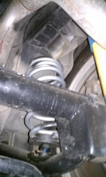

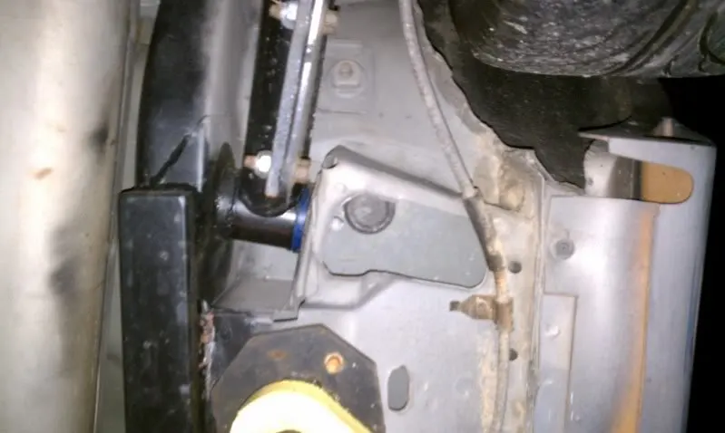

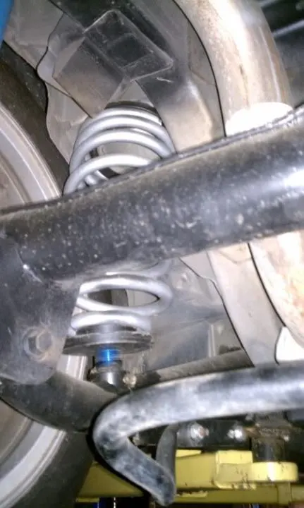

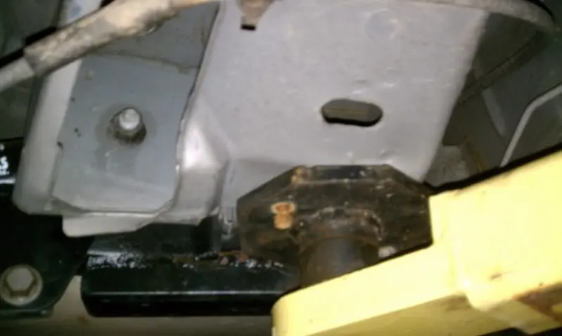

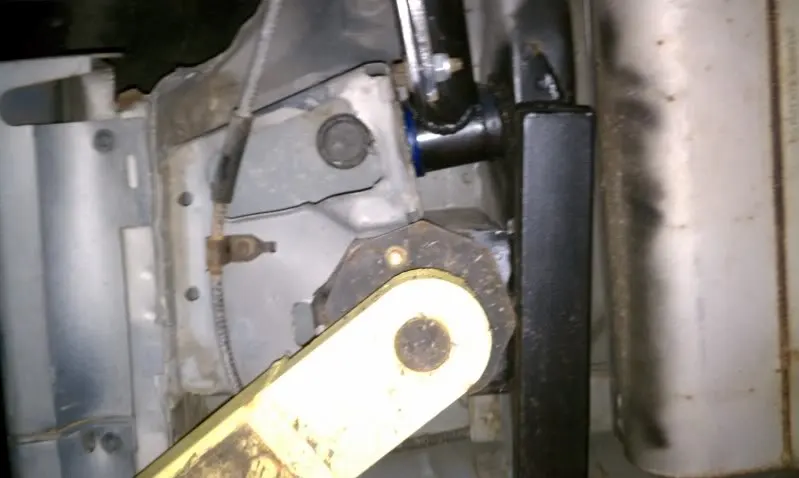

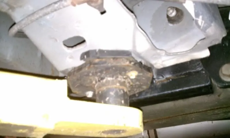

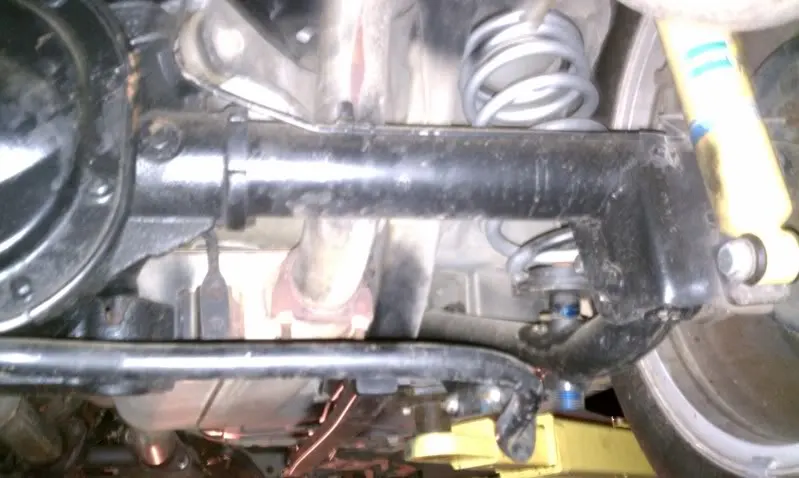

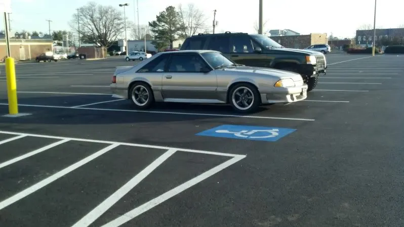

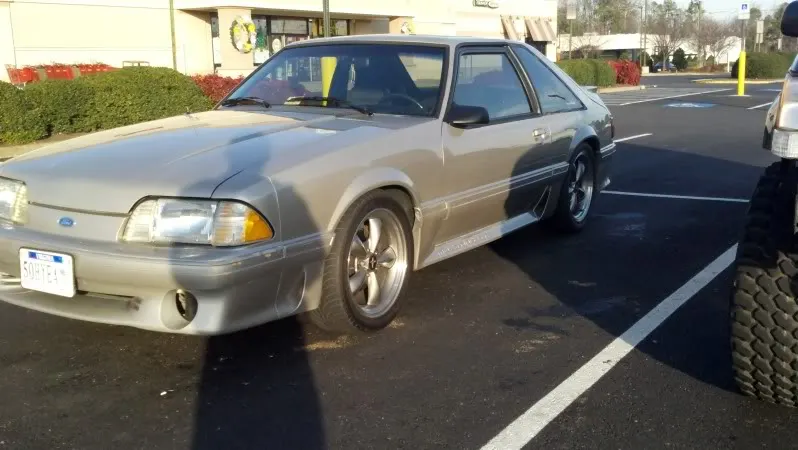

got it on the lift to see what was going on. see anything out of the ordinary? looks like torque boxes to me.

Maybe the car has been in a accident or slid into a curb and it pushed every thing over.
Check both socks and see if the ankles are the same, vertically to the ground.
I.m painting my car and found damage to my rear quarter under the paint.
Most foxes has/had damage to the front or the sides from sliding into things.
no thats just where the subframe is welded. i did spin it out and hit a 45 degree curb once with the car, and the odd thing is that i hit the passenger side, so if anything that should have shoved it back towards the driver side right? the axle is too far to the passenger side.
i did rear end someone a while back, but the car had these ride height issues before that happened.
i plan on taking this car to the best frame shop in town and getting their opinion on it, just wondering what torque boxes look like when they get screwed up, and what can cause my axle to be so out of whack. car has had stock LCA's in it till i put extreme duty maximum lowers in it.
