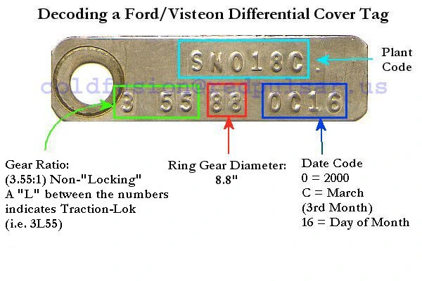

2SL73A887L19 = 2xx73x88xxxx = 2.73, 8.8"
This method is from some website I stumbled on a while back, so I guess there's a chance it's wrong, but it's been right every time I've used it. I'll dig through my favorites folder and see if I can find out what the other stuff means too.
The gear ratio is easy - just rotate the pinion flange and count the ratio of pinion turns to one turn of the axle. So many of these have been modded that I wouldn't trust the part number to indicate the gear ratio that's in the housing anyway. While you're spinning things - rotate one axle and watch the other. If the other axle rotates in the same direction, you've got a working traclok. If the other axle rotates in the opposite direction then you've either got a non-working traclok, or you've got an open diff.
axle decoding courtesy of coldfusion
Maybe this will help.
