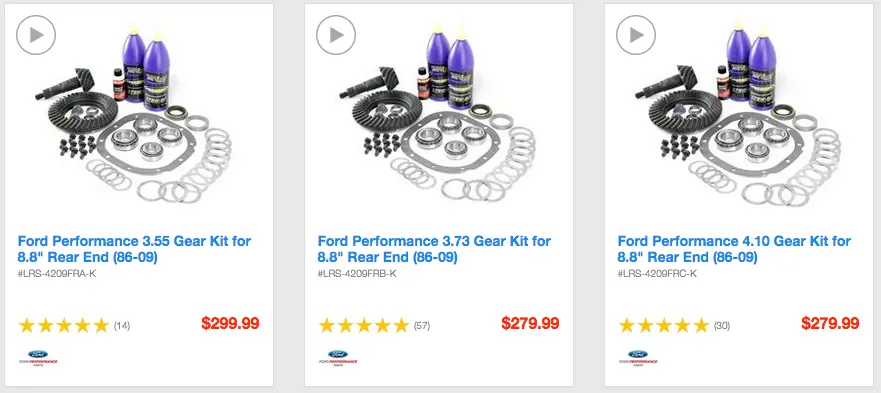

My gut says 4.10's but I'm not sure how bad the RPM's are going to be.
So, now that I've rambled on, Please tell me what you think the best rear gears are for an automatic!

I wouldn't worry about your rpms more than how different the car is going to drive. You'll have one less gear in an AOD, technically 2 less since you shouldn't be beating on the car in OD.
I have 373s and just passing over quarter mile close to redline in 3rd gear.
I'd say go 3.73's. You might need a slightly taller tire as I was crossing the traps in 3rd pretty much at redline in my car when it was an AOD.
Also, since you can't go WOT in OD, it make driving at higher speed a PITA. You basically do lose a gear, and top end driving is different now due to this. On a Daily driver, I found it to be annoying at times to drive on the highway. On a weekend fun car, probably not so much unless you want to drive an hour to/from car shows or the track.
If this was a trailered drag car...4.10's or 4.30/4.56. You'll just need to adjust tire size to make sure you don't run out of 3rd gear before the traps. This alone may limit you to 4.10's.
The idea of 4.10's really only appealed to the 16-year-old in me lol, but you guys have definitely confirmed that I won't be doing that.
I'm basically thinking that 3.73's are the way to go or (based on what you guys are saying) the 3.55s but only if it helps with the top end redline issue you guys had mentioned.
It all depends on your use. I will say, 3.73's and a good sticky tire is fun in an AOD car. I went from 14.6's to 14.1's in my AOD LX with just a change to 3.73's in addition to pullies and a cobra intake and exhaust mods. A good 2-foot launch and i'd be out front of all my buddies and their stick cars and they would have to play chase. It woke the car up that much despite it's top end shortcomings which only became a factor as the top end of the track, and when I was on the highway driving 1hr+ or so.
If you said your use was DD mostly and an occasional drag strip pass, I'd say go 3.55's, but since this a weekend fun car, I'd go 3.73's.
But really...it;'s your call as you will be the one driving it.
I'd recommend adding a bigger trans cooler and bypassing the radiator cooler all together.
As quick as my car was with the AOD, I did eventually swap it to a 5-spd and haven't been back to a track since.
