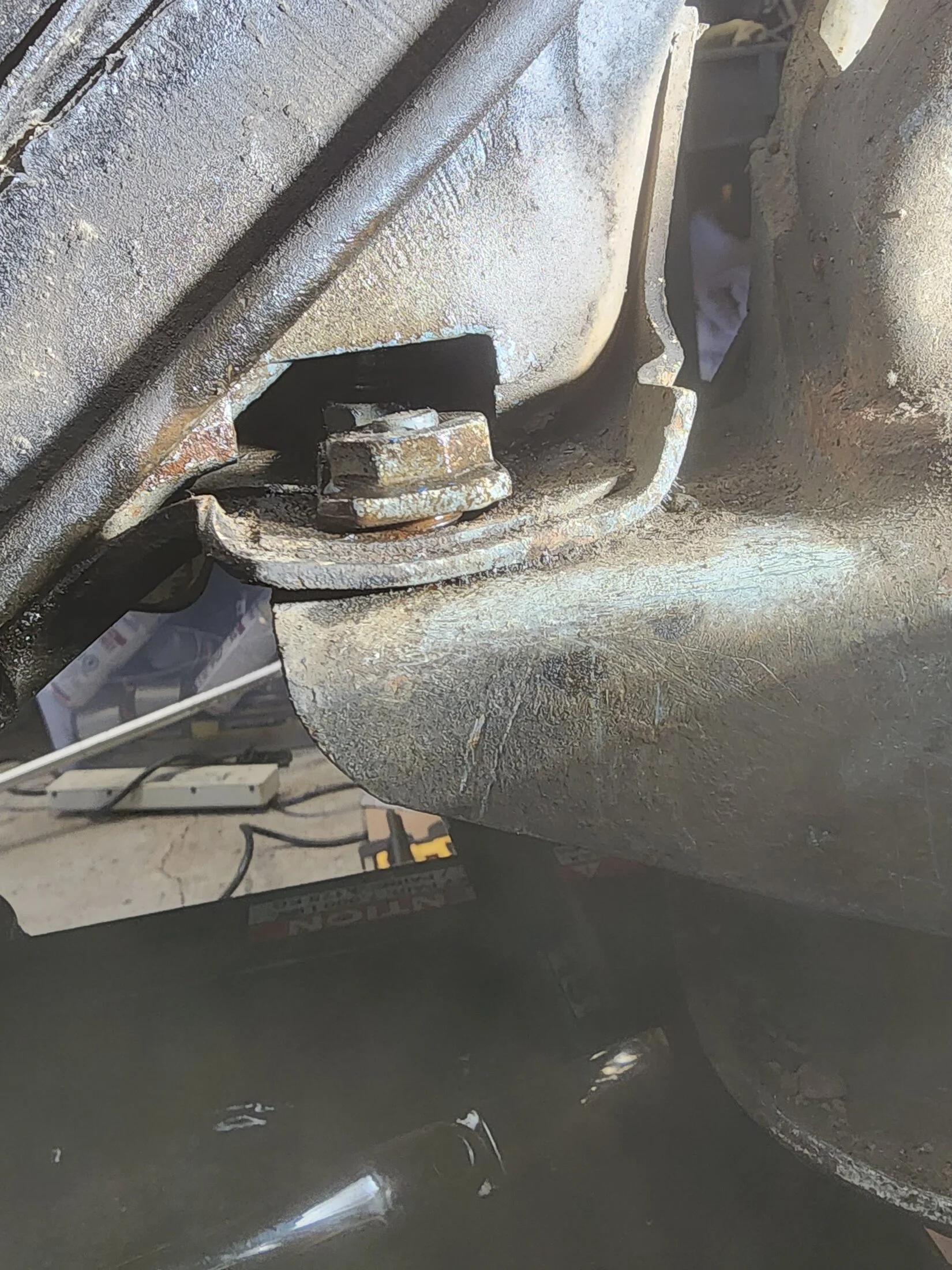

So the nut in the back keeps spinning on top of the plate...i can't get anything inside there to hold it down...any suggestions?
What about cutting it with a small dremel? A pain but you will be replacing this anyways.....
Cut it, whack it with a chisel to spread it some, and then your needle nose vice grips can hold it...
If all else fails cut the head of the bolt off so you can drop the K-Member. After the K-Member is dropped cut as much of the body of the bolt off as you can flush with the flat mounting plate. Should be able to get the nut and what is left of the bolt out then.

Be sure and have it supported with a jack or something.......
