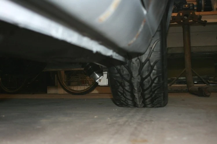

really, mine didnt come close. the wheel well had to be widened. i didnt want to hammer away on brand new panels lol i wanted it to look professional, so widening them was the best option. now if i ever decide to go bigger theres all kinds of space in there.:nice:

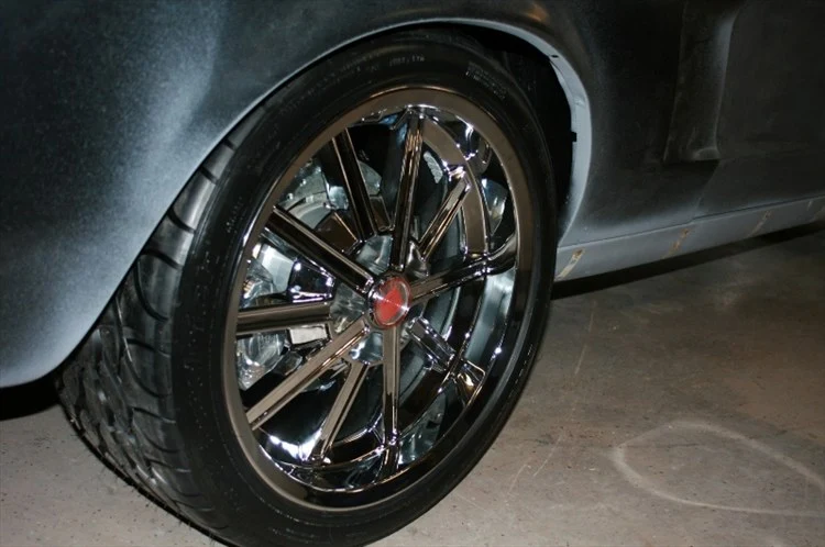

My wheels specs and I have plenty of room ande I haven't rolled the fenders yet:
Shelby Wheels - CS67 Chrome (18x8.5 front / 18x9.5 back)
• BFGoodrich g-Force™ T/A® KDW (245/35ZR18 front / back 285/35/18)
