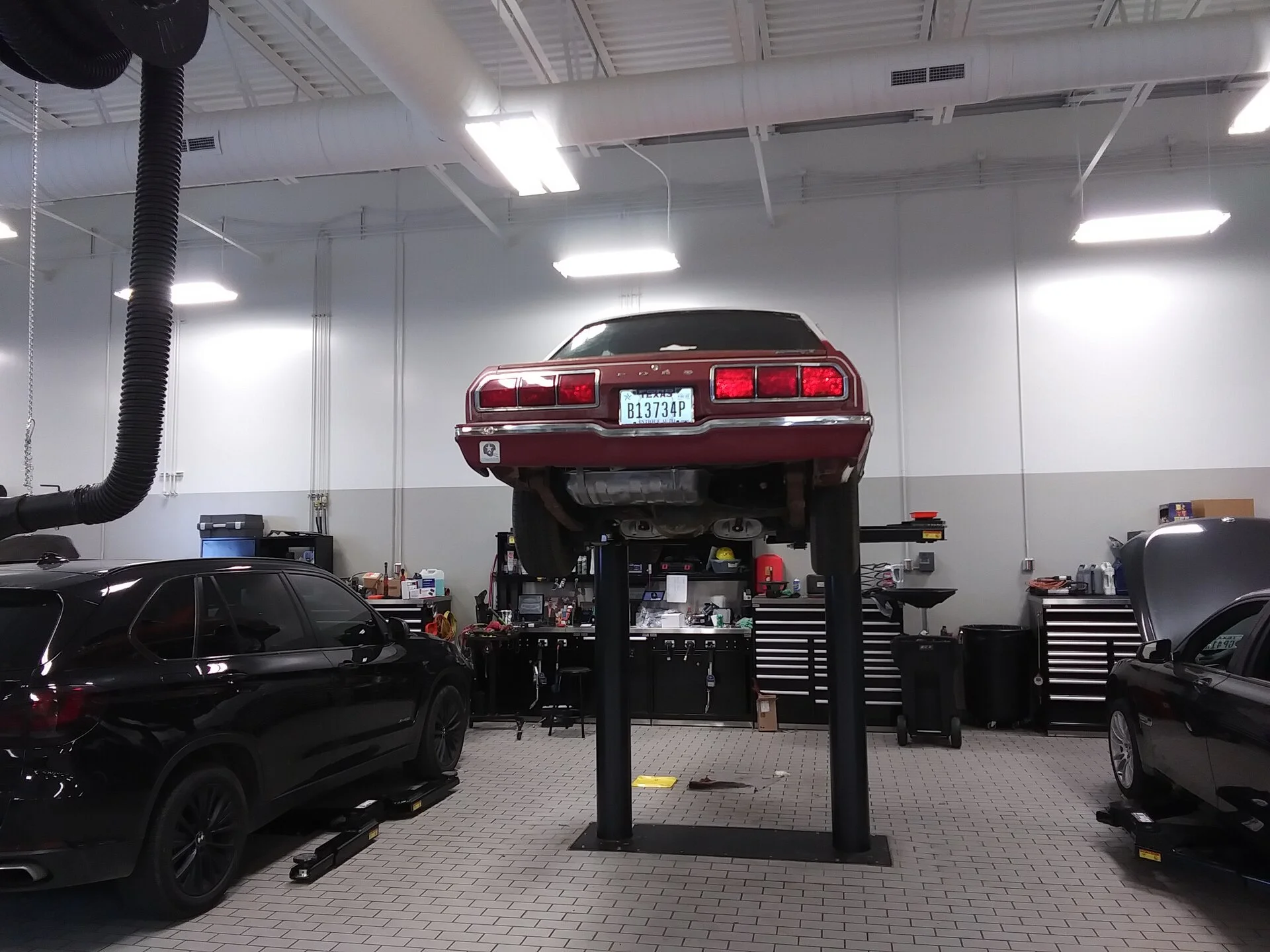

I'm at the shop with it today. Did the alignment, blew all the leaves and rat crap out of everything but the cowl (no idea how I'm going to clean that out without pulling a fender), played with the traction bars, fixed a vacuum leak, and I'm doing the coolant flush now (also did an oil filter housing on a customer car and had lunch).

look at that nice clean shop
That's one of the shop foreman's bays. I had a 328i in one of my two bays, and the service manager had his pickup in the other when I got there, so I put the II in the shop foreman's bay since he was off today. Picked the car up to double-check everything and to show off the subframe connectors and exhaust to a co-worker.
My bay is MUCH cleaner.
