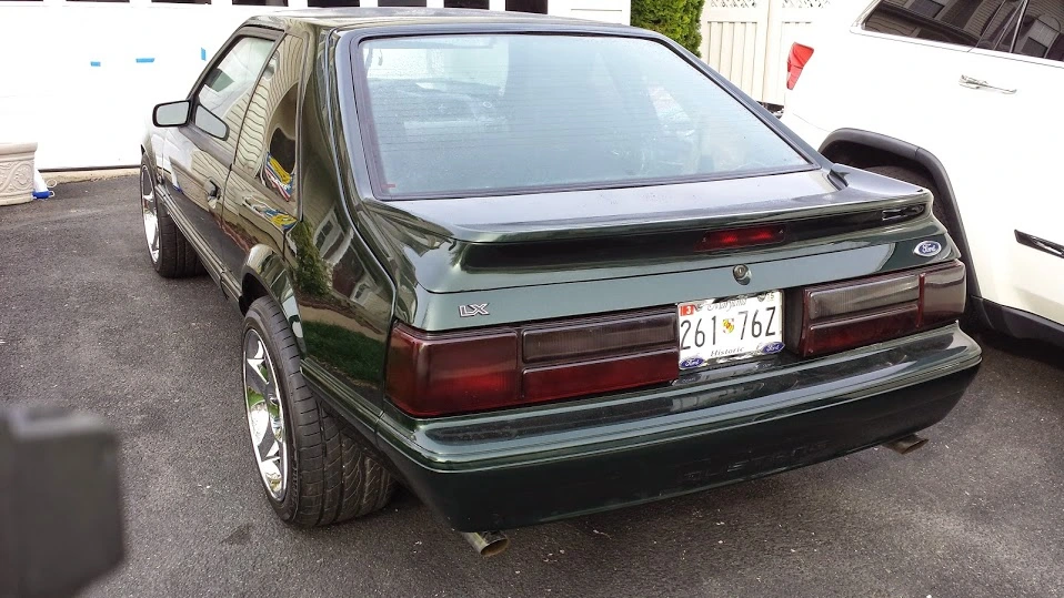

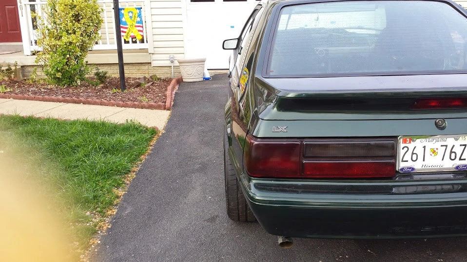

So...been restoring a 1992 GT and have already replaced rear control arms with BBK Gripp and done the axle conversion to boot. Then removed quads.
Bought some 17x10.5 bullitt rear wheels and , upon dry fitting them, found that they contact the rear coil springs :/
I'm stuck and need advice. Should I invest in bolt on spacers? Will the fenders require rolling?
For now, I have Bridgestone RE760 sports 275/40/17 that I plan on stretching until I can afford wider rear tires. (Poor planning cause I recently bought them new)
The current rims are stock 2001 17x8 bullitts that I run with a 5/8(?) spacer .
Any help would be swell. Thanks to all!

I have 10.5 rear wheels on a 275 and I don't rub too much anymore. My outer fenders are rolled and minor massaging of the inner fender. I'm thinking about getting rid of the 10.5's because I really don't care for the inconveniences.

The 10.5" rim should fit without the need of spacers. Did you order SN95 wheels, or did you order 10.5" wheels specified for an S197 wheel? This is important as the SN95 versions should fit without spacers and not be near the spring, while the S197 versions are deeper, so I can see how this would be an issue

Boy, that 275 really is stretched onto those wheels lol.....and I thought the 275's on my 10" wide wheels looked tight.
