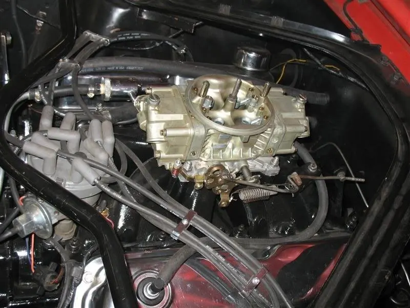

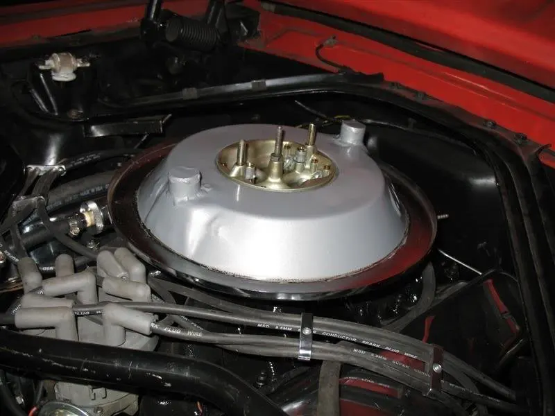

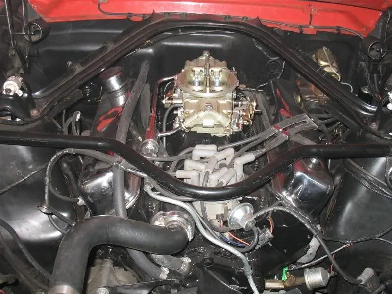

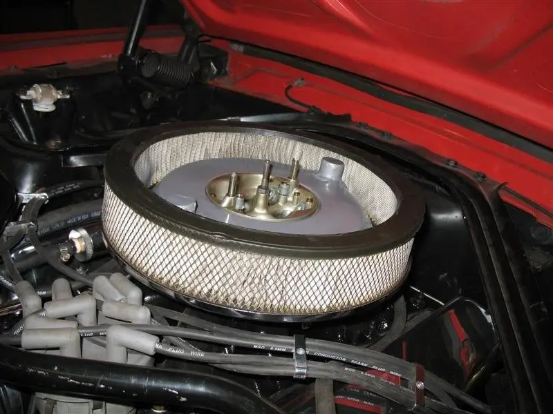

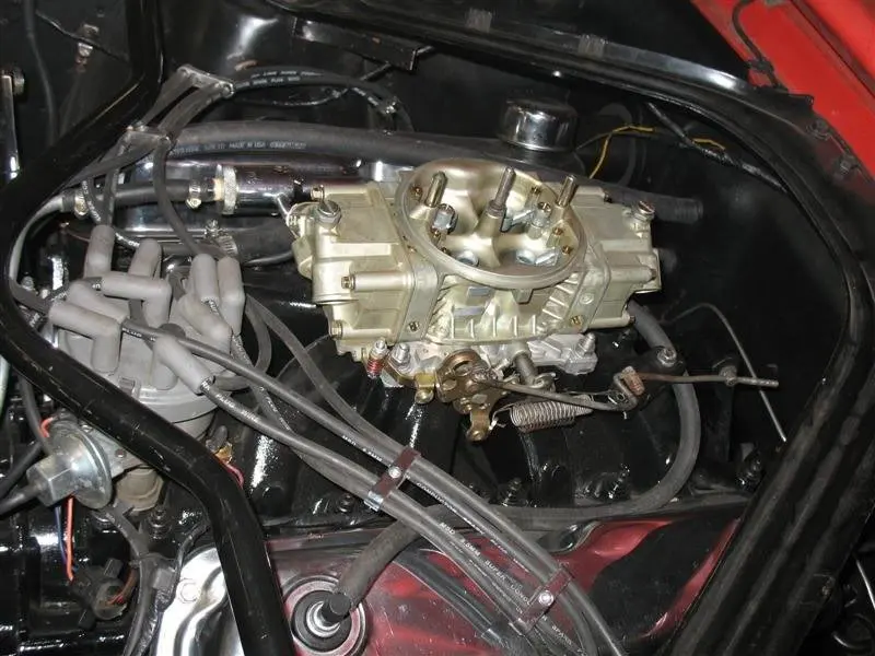

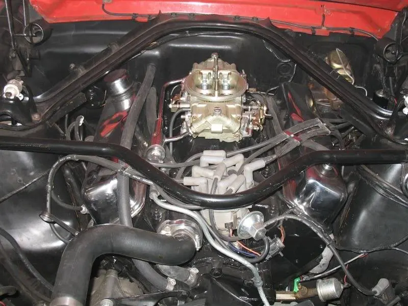

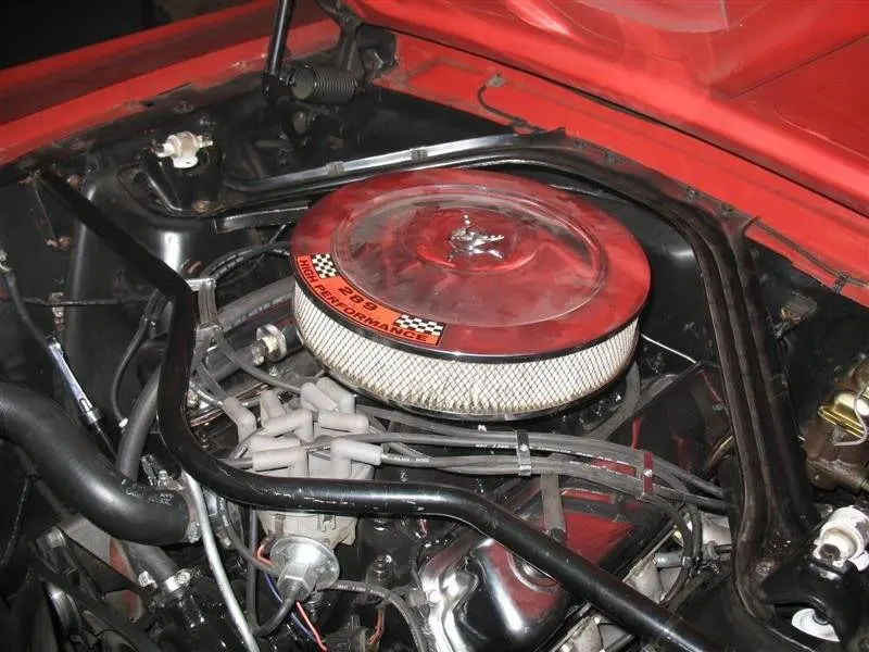

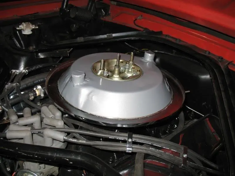

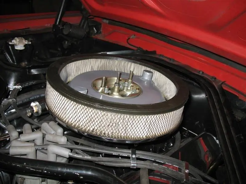

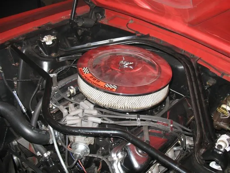

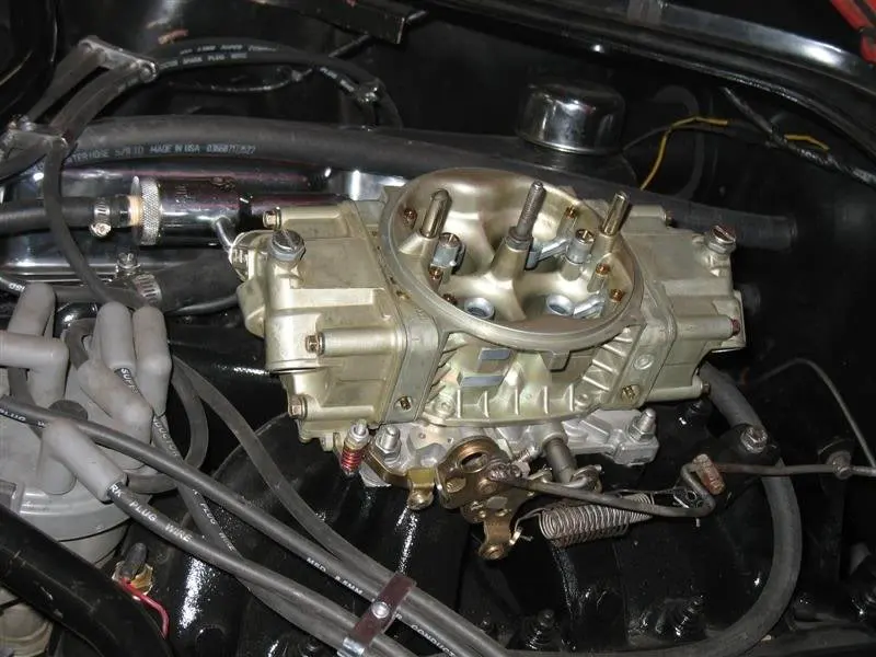

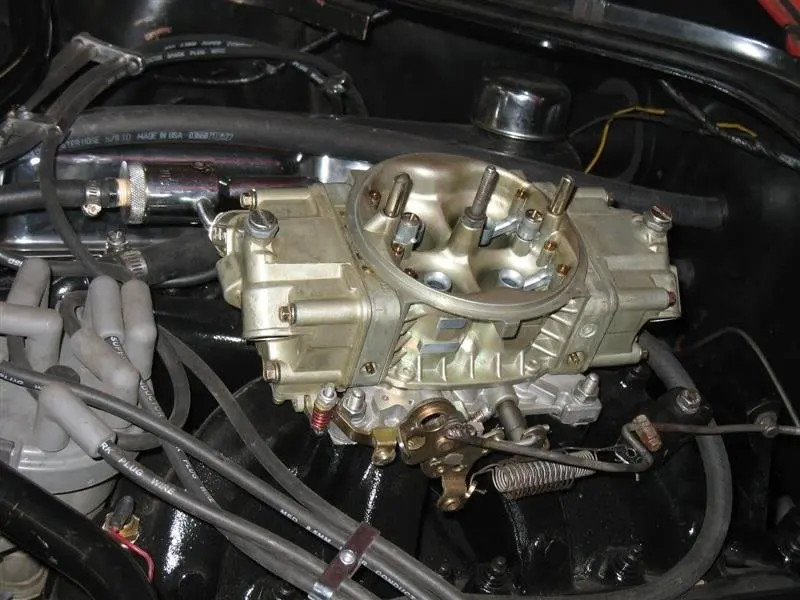

Vic Jr heads will be fine for a 393/408. For a primarily strip vehicle with minimal road duty, you will want a decent cam. That will require an upgraded intake manifold above the normal dual planes and a Vic Jr. intake is recommended for performance usage. Although people claim it can't be done, a Vic Jr. can be fitted under a stock hood with a little planning and a few mods. I have about 1/2" hood clearance which is about the same as my old Stealth intake. Here is what I did on my 393w equipped 65' in order to install the Vic Jr. intake:
1. Dropped motor mounts.
2. Angle milled Vic Jr carb pad--took .300 off front, near 0 on rear. Gives the added benefit of a more level carb. No clearance issues with carb studs.
3. Modded 14" drop air cleaner-maintains the desired minimum 1 1/4" base-to-top clearance.
4. Chokeless HP type Holley carb has lower air cleaner flange.
Some pics of my 393w with Vic Jr:
Although my 65 has a Shelby scoop, no part of it is needed to clear the 14" air cleaner shown. The Accufab headers that I installed helped me to maintain above average ground clearance, even with the drop mounts.
