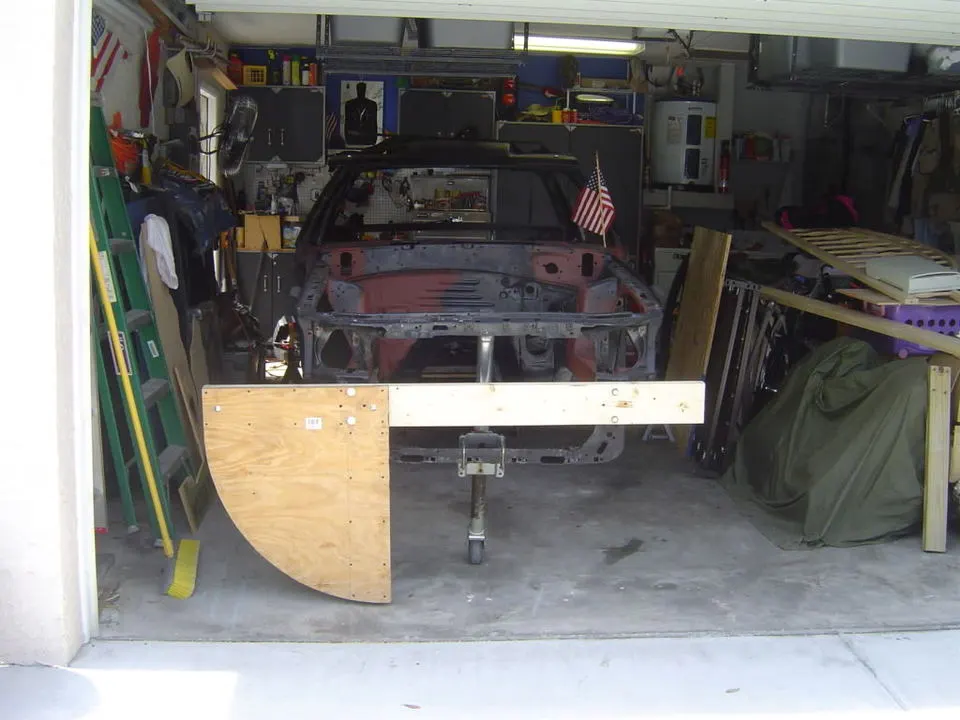

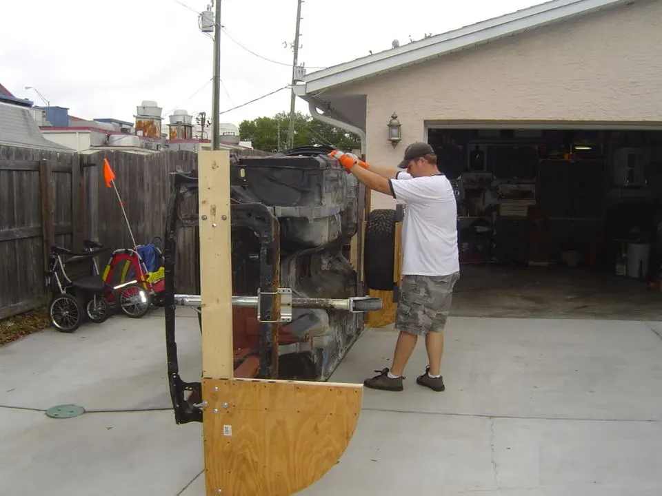

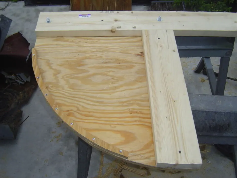

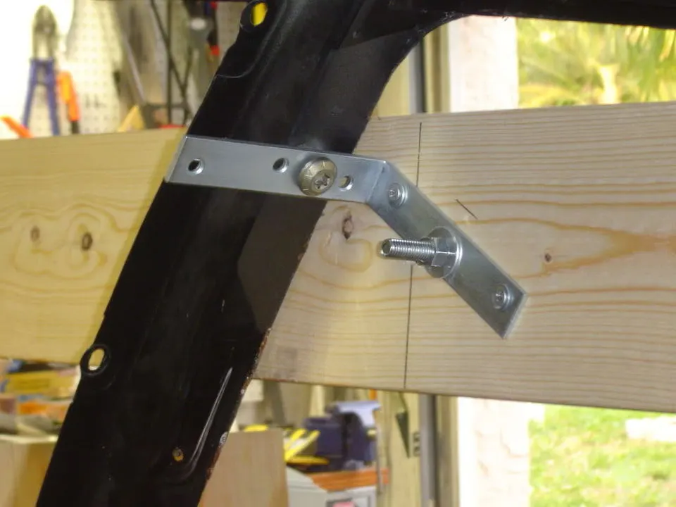

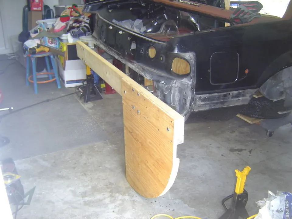

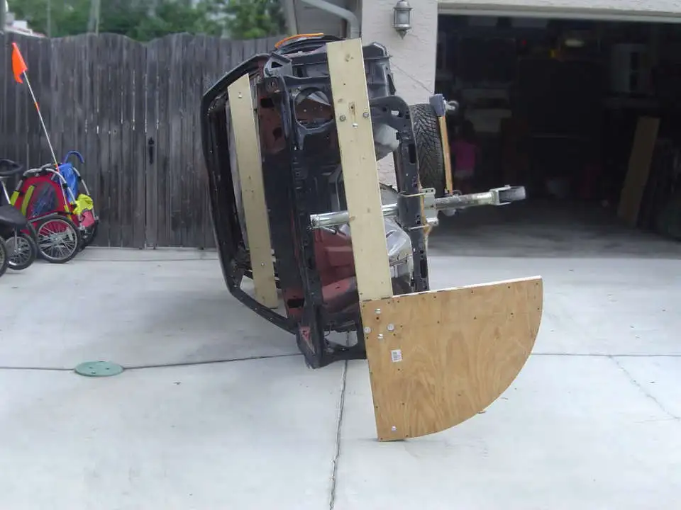

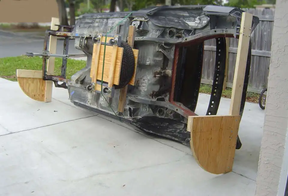

Saw this on another forum and thought I'd steal the pics for you guys. I hadn't seen anything quite this simple until now.

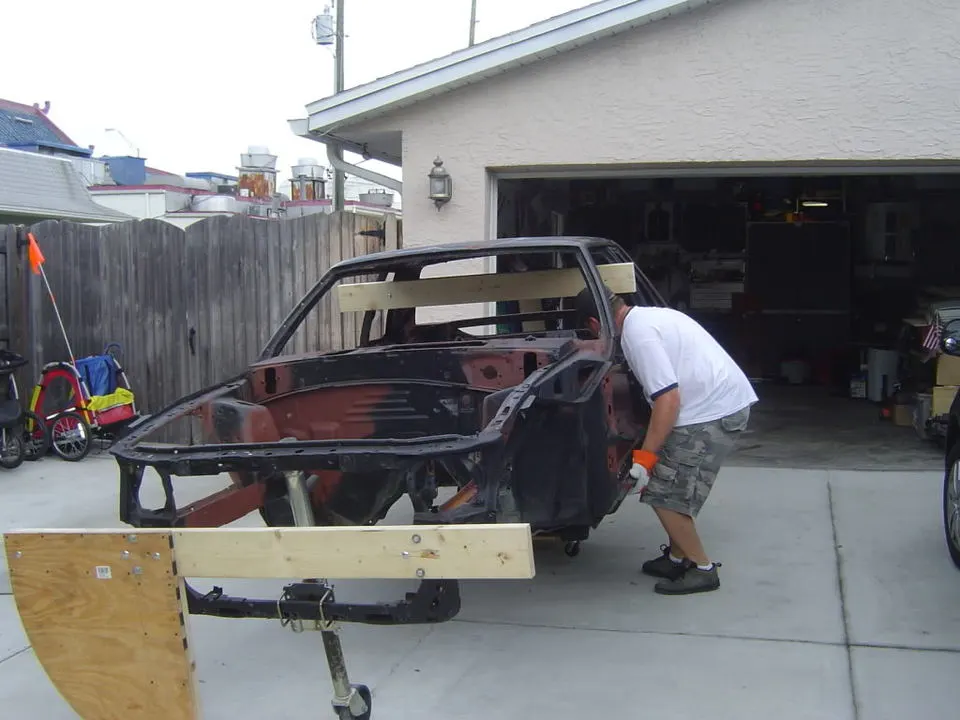

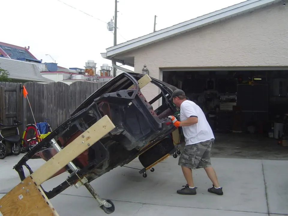

The closer the pivot point is to the car, the easier it will be to tip.
