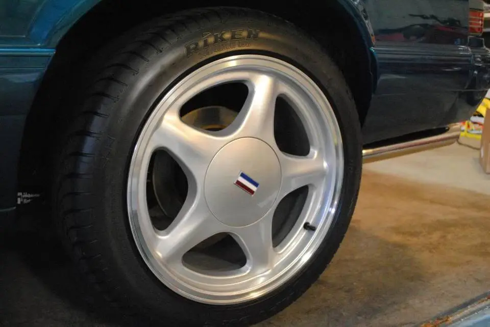

Your car looks really awesome - ola - especially w/those Pony R's - I'm surprised you didn't go Chrome Pony R's - I think they 'make' them - anyway - looks great - Your really making me "lean" towards painting my coupe reef blue...:).....it was the "IT" color w/the black interior - back in the day - I used to be able to go to the showroom and see them new..............:leaving:

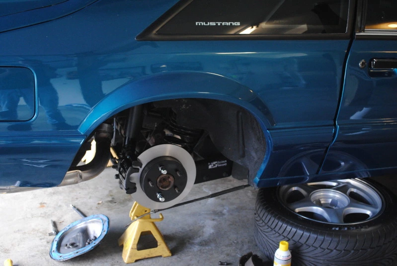

Here's the progress on the rear disc swap. Either though this is swap straight forward, it has been a huge PITA!
Finally finished up the disc swap, just need to do the e-brake stuff. The brakes do not seem very powerful and the pedal is pretty stiff; I might try to re-bleed to see if there is more air.
