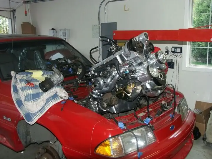

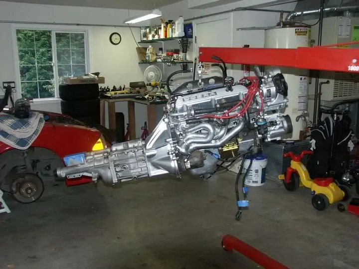

You don't have to do it this way, but you can! I stuffed every damn thing on the engine before dropping it back in!!
definetly put the headers on first. just be careful lowering it in like marlboro man said. its waaaaaaaay easier putting the headers on while its on the stand.
and cobradvdm i wish i had the intake lift plate so i could have bolted all my acceseories on first i had to use the holes in the heads for the acces to attach the chains. and the secret to putting the trans on with the motor is getting the car high enough
Any particular reason why you want to pull the trans out from under the car? I would pull the engine, bellhousing and trans as a unit then you can unbolt the trans outside where it is easier to get to and do the same with bolting it back up.
