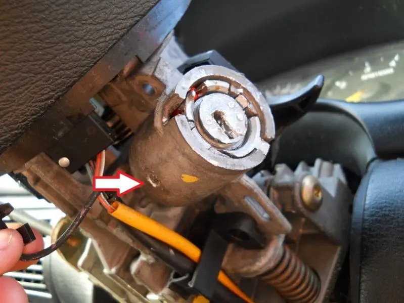

Anybody know how to get one of these things out? I know there is a little pin that one is supposed to press inwards and then they should slide right out of the housing, but my cylinder is stuck in the off position (you can only press in the pin after you've turn the key to the run position--for antitheft purposes, I suppose). I tried drilling through that retaining pin (noted with an arrow) with an 1/8" bit but even after completely drilling it out, the cylinder still isn't sliding out of the housing.
Any ideas?
After further research, it looks like even if the pin has been drilled out, the cylinder still needs to be in the run position to be removed from the housing. It looks like i'll be drilling the cylinder out completely. I've never done this before, any tips are welcome. Wish me luck.

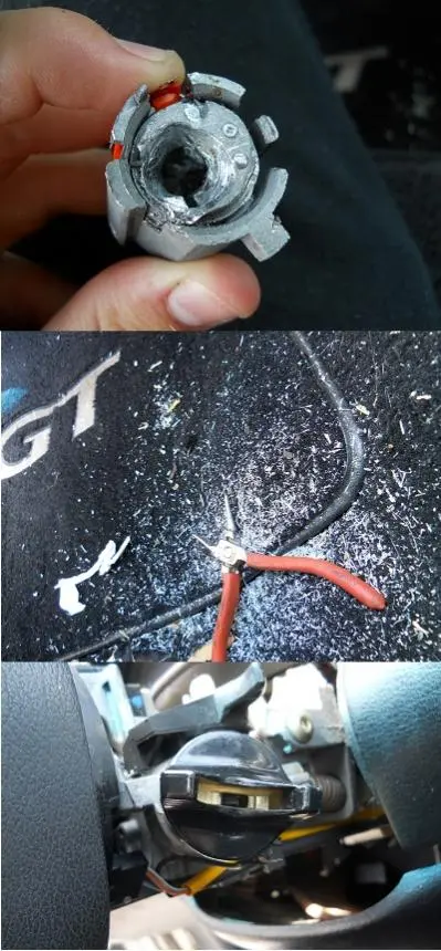

All done. Drilling that thing out was a pain. Although this thread has turned out to be me talking to myself, for the sake of conclusion, here's some pics, lol:
If anyone wants to repeat this experiment, PM me or waken this thread and I'll drop some knowledge.
