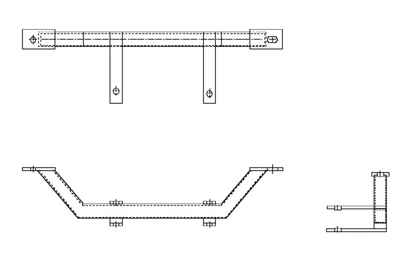

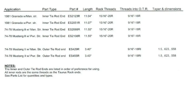

Again all of this has been heavily modified to fit my particular application. I am trying to post the information on the Taurus Rack Install. I got most of my turning radius back, but am still not 100% satisfied. Between being busy and not having any money, it has been difficult working on this project.
Anyone interested in me making them the rear steer bracket? How about modifying the caster camber plates for them. I would of course do this for a fee, just something I thought I would throw out there to try to make some money to continue to develop this project. Thanks and talk to ya' all later.
Taurus Rack Write Up
