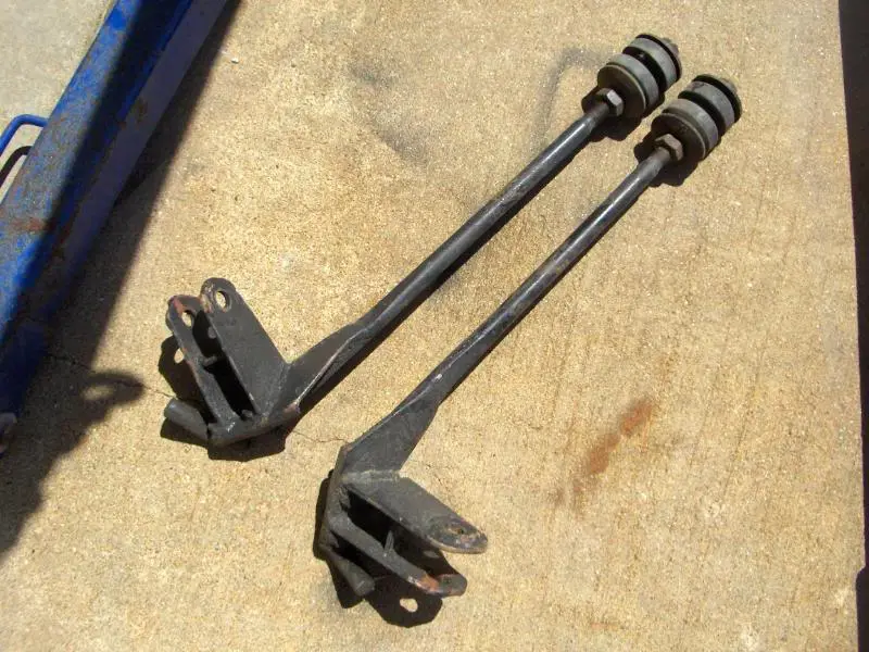

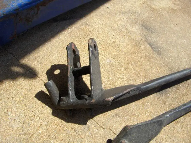

To get the Tacoma struts to work I cut out the inside of the upper A-Arm, sold those. I then modded the strut rod (caster adjustment) to accept the Tacoma Strut. I still have those if anyone is interested.

I don't know if this is what you were talking about with strut mount, this or the upper strut mount. The picture below is what I came up with for mounting the Tacoma struts to the lower arms. They are not pretty and are going in the scrap metal pile, but they got the job done. I will post pics tomorrow of the camber plates and how I modded them. Thanks so much for your patience. I am in the process of ripping out my rear end (ha ha) and replacing the 1/4 panels, wheel wells, and trunk floor, what a process!!! :jaw:
