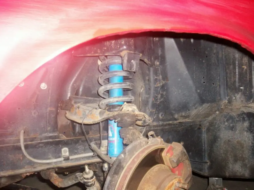

I retrofited some Toyota Tacoma Struts into my 67 a few years back. They came off of a 4x4 V6. Handles really well, just way to stiff. I need to find the springs for a V6 2wd or that of a 4cyl 2wd. I custom made the mounts on the bottom and modified the a arms to allow the strut to work. My problem is this, besides it being to stiff, I have a Taurus R&P in it and the inside of the tires wear down really fast. I did the shelby 1" drop to the upper Control Arm when I first got the car and left it that way. Should I put this control arm back and would anyone know where I can find some different coil springs?
I don't drive it much, if any at all. It has been in storage the last 1.5 years at my parents house. We are thinking about bringing it down to where I live so we can take it for a spin every once in a while. Everything has been redone except for the body. Fun car and a great hobby for a stress reliever, or stress maker sometimes. Thanks for the input.

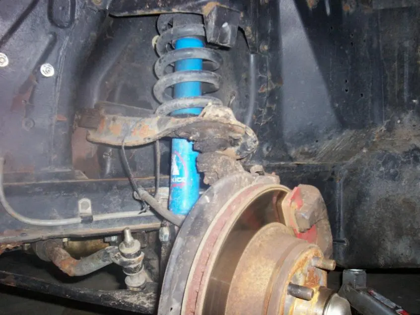

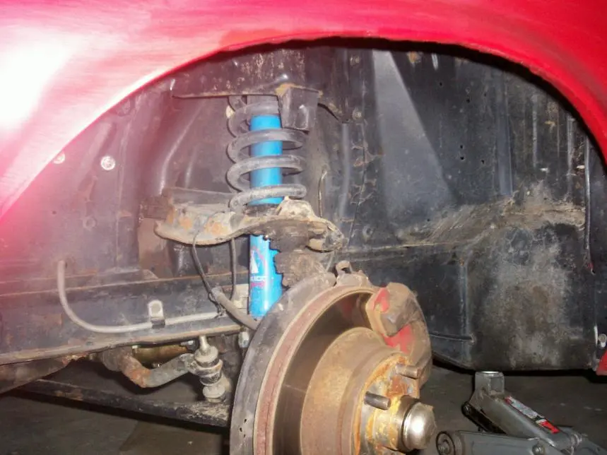

I have some other pictures, not much to show the mount point. We have decided to bring it down to our house. We have someone about 4 blocks from where we live that said we can store it at their place so it is still covered. I am going to work on the mounting design for the bottom part. I have attached the other pics I have. I can try to talk my dad into taking some pics, but then to get my mom to attach them and email it out, better just to wait. Anyway, here is what else I have.

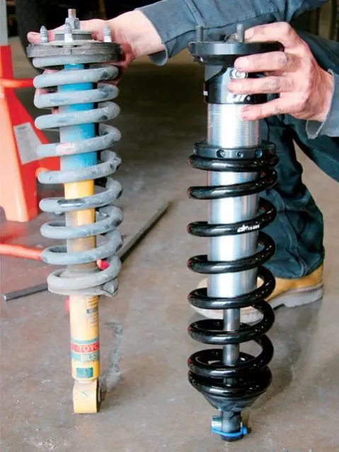

I have attached a pic of what the struts look like, they are on the left. The other struts are for a beefed up tacoma and a re rated at 650.
