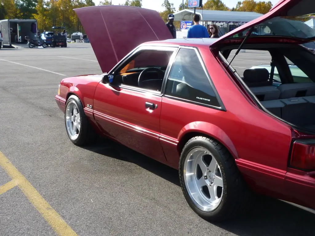

These will all fit:
For the tire size, you can fit a 275 in the back with a 9-inch wide wheel without much issue. You might have to roll the fender lip.
In the front, you can get away with a 245 on an 8-inch wide wheel with no issue.
Wheel height doesn't matter so much as overall tire height. Whatever it is you like the look of:
