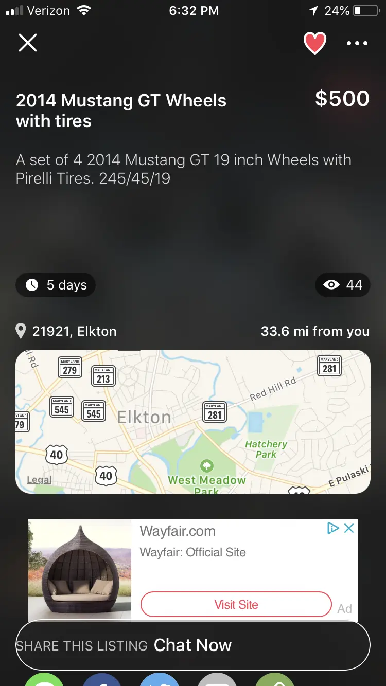

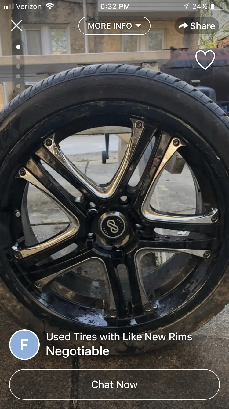

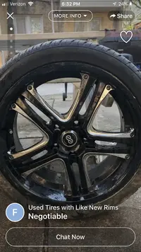

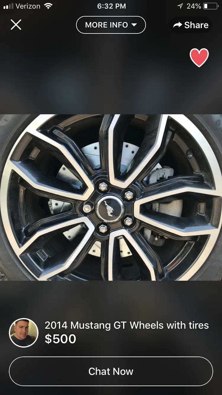

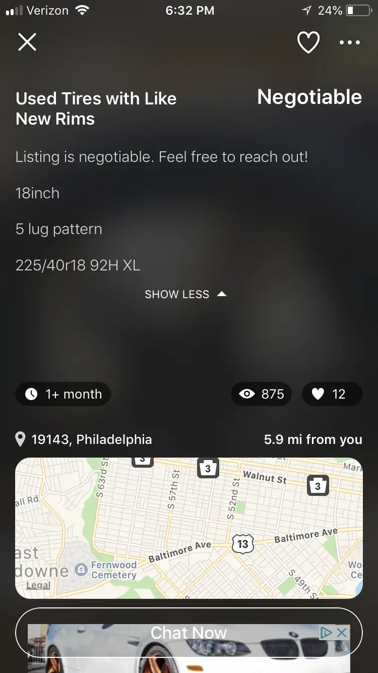

The wheels I’m looking at came off of a 2014 Mustang GT. Also another one I was looking at just looks like after market wheels and rims.

The bolt pattern sizing may be marked on the back of the aftermarket rims...hard to say. Regarding wheels from a 2014, the article I linked to you states:
  • "SN95 Mustangs (1994-2004) can use 2005-2014 wheels; they will be tucked inside the wheel well and will require a spacer". ((A spacer to bring them even with the fender lip)). Ends up being your call on what looks best on your car and what works best for your mod plan.
