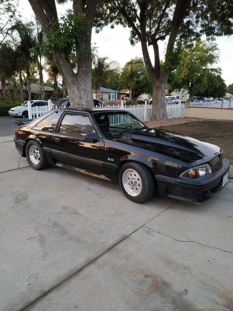

So I've got an '88 Fox with '96 GT front spindles (5-lug), calipers, discs. The calipers have the 'bracing bracket' deal that makes clearance an issue on certain rims. I understand from reading around that the width of the front track increases by .96" on each side for a total front track with increase of almost 2". Not a big deal, right now I'm just looking for proper offset/backspace sizing that will fit for street use. My current setup is for track use, and my front weld rims rub the fender wheels on any suspension impact, and/or turning of the wheels.
So that's the real question: Based on my modified front end setup, what size rims can I run? It's be GREAT if I could match my rear 15" Weld rims (9"), but if not, I'll put new metal on all four corners.
Thanks all in advance!

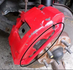

I'm currently running 4" welds up front. The reason they're rubbing on the top of the fender well is because I'm using a spacer so that the GT caliper's outer brace (that cast portion that reinforces the outer portion of the caliper, see attachment. Not my exact caliper but it gets the point across), it would bind with my rim without the spacer. That's mainly because the offset on that rim was originally perfect when I was running much smaller brakes on the track.
So basically, I don't want to use the spacer, and want to get a wheel with backspace/offset that will let me fit it in close to factory.
Does that clear things up a little? @trebor3170 says anything that'll fit on a 94+ will plug in there. If that's the case, that'd be great. Just want a weld wheel knockoff to approximate the rears and get my ass back on the road!
