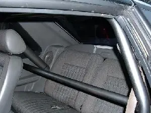

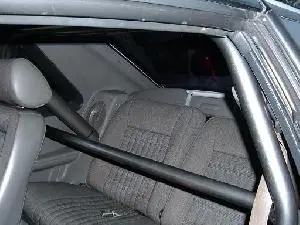

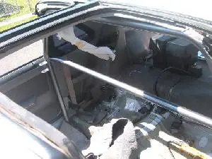

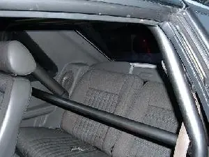

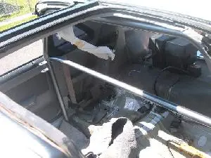

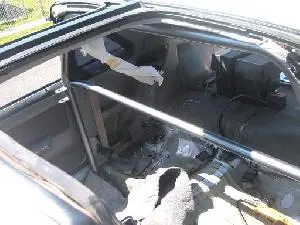

I have the maximum motorsports bar. It went in very easy. Here is some pics of the install.
It was $500.00 shipped.
Its a bolt in.
Pull out the pin for street.
Its a bolt in.

The shipping bill showed 65 lbs. Can't say on the 1000' track, but 11.49 and quicker for the 1/4 and I think it's 7.49 in the 1/8. The bar is good to 10.00.
