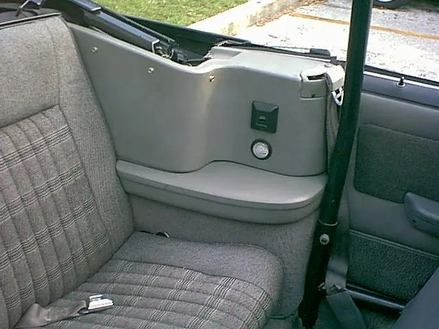

hey hamonkeiser, can you give a pic of where the rollbar goes into the rear quarter panels? What did you have to do to install it, cut through the interior quarter panels? Id like to see that, thanks.
The shop just took out the rear seat, welded to the rear rails, notches the sides ot the rear seat & but the seat back. The rear bars run between the sides of the rear seat & the interor quarter trim panels.
