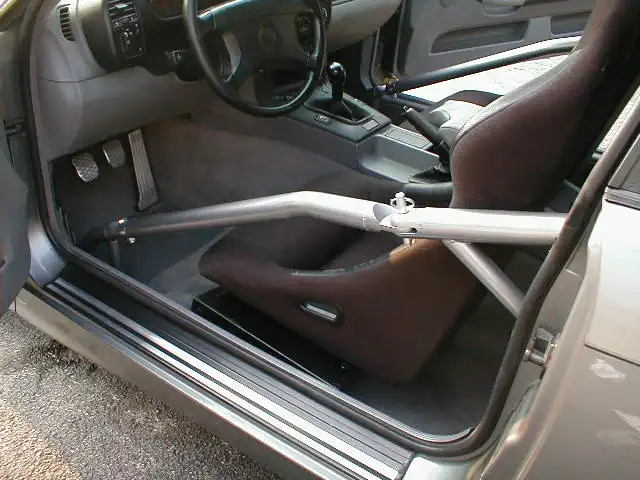

I'm having a custom 6-point done once it warms up. I was talking to the owner of the shop and he said that swing-outs are more trouble than they're worth. They scratch the hell out of the door panels and he said he's seen countless amounts of cars whose bars went through the door windows because of wind blowing the door shut or something when the bars are swung out. They also weaken the integrity of the cage a lot too. So, I'll be getting welded in bars.
That's not NHRA legal to have the main hoop crossbar bolt in.
here's an example of swing out bars. You can pull the pin out and the door bar will pivot outwards
