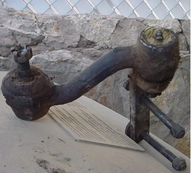

Hey John, I took off the idler arm from my 68 hoping to do the roller conversion, but mine looks completely different than yours, the bracket does not have the stud built into it, instead it has a hole and the stud is built into the idler arm. Is there a way to make these kind of idler arms work for the conversion, or do I need to get the arm and bracket like the type you have?
Thank you
Thank you
Well, this is getting good. That idler arm doesn't have a rubber bushing on either end, so it's a 'rollerized' unit and should work well in like new condition. Your center link must have a hole in it to mount the idler arm, rather than a stud like our 68 coup with P/S. I'm learning more about the newer Mustangs all the time.
The roller kits I'm working with slide over a stud. If the idler arm uses a tie rod end type of bushing, then there is no stud. Anything to free up the idler arm will work. If you can't wiggle the center link up and down with that idler arm installed, you win, no roller kit needed. It is odd that our 68 with P/S uses a idler arm with a bushing at each end and yours doesn't. We all know that Ford did some odd things to these cars and here's some proof.
That idler arm you have is what you want. Greaseable and smooth operation. For someone like me, I would have to replace the center link, idler arm and bracket to get what you have. I say put it back on.
I don't know if that's a P/S or manual set up. Are you going to put the manual conversion piece on the drivers side of the center link to convert it to manual or chage the center link? If it was me, I would add the conversion piece and call it good.
John
