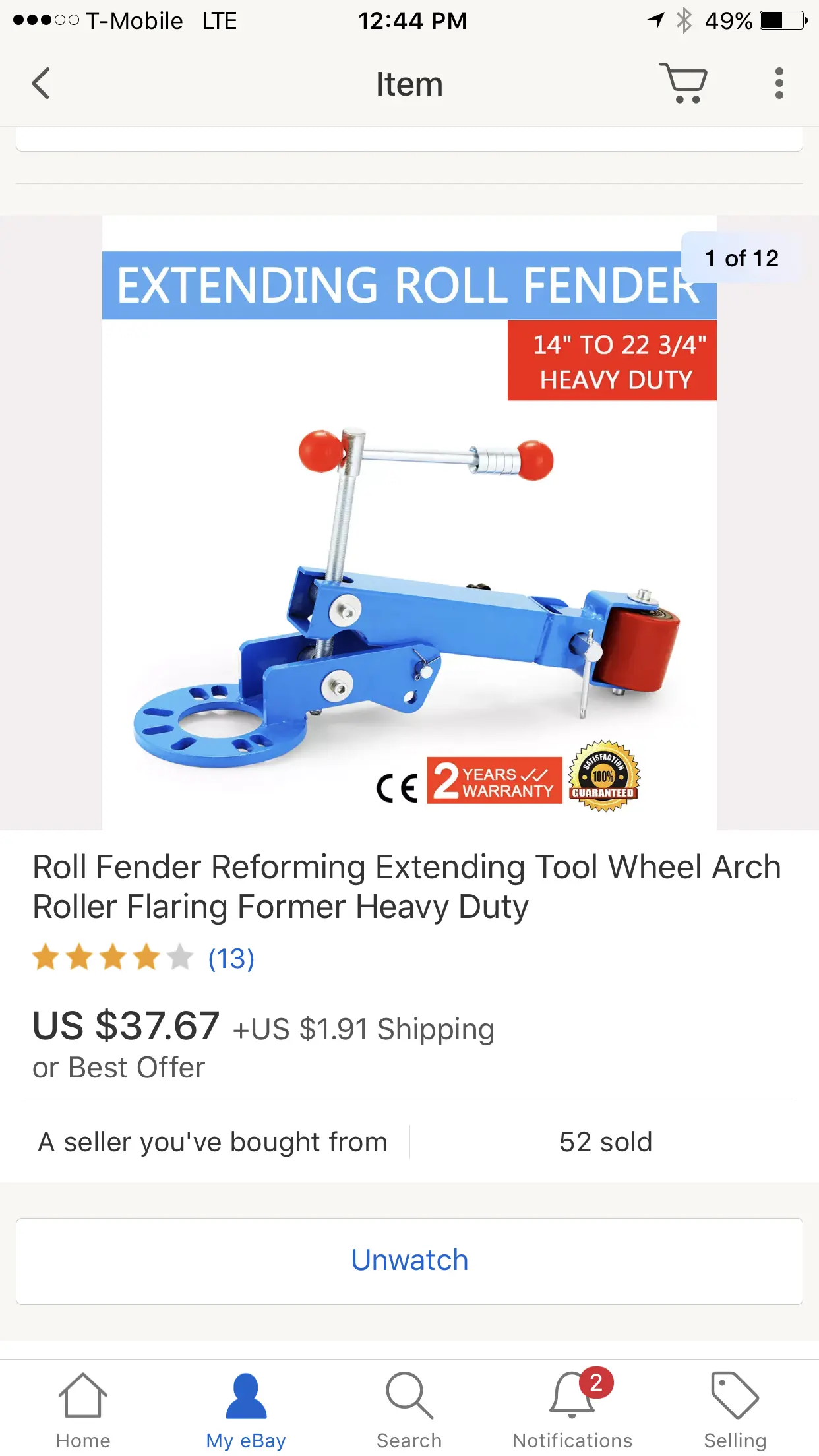

Just search fender roller on eBay. It's the Eastwood one without the logo and upcharge.

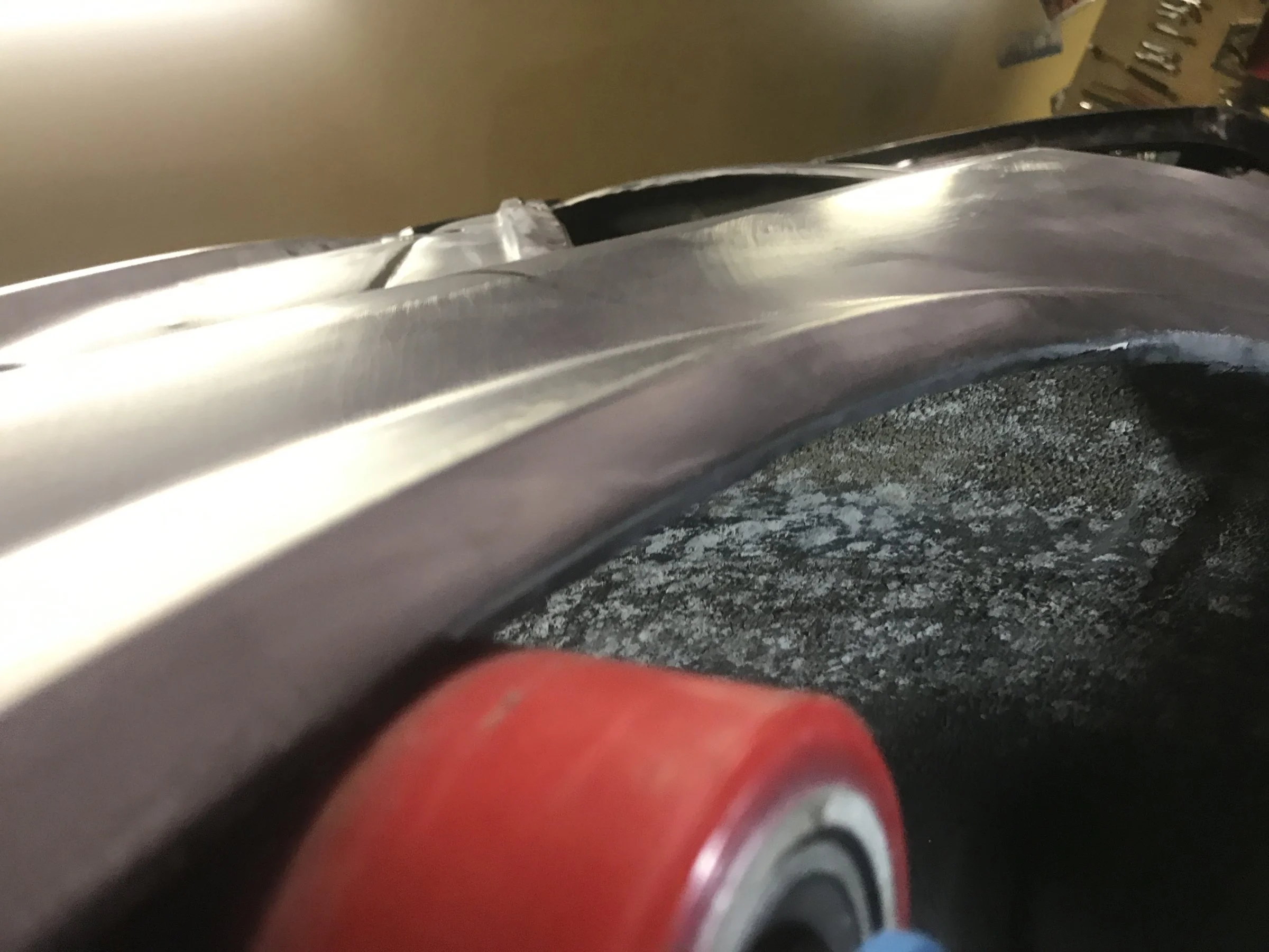

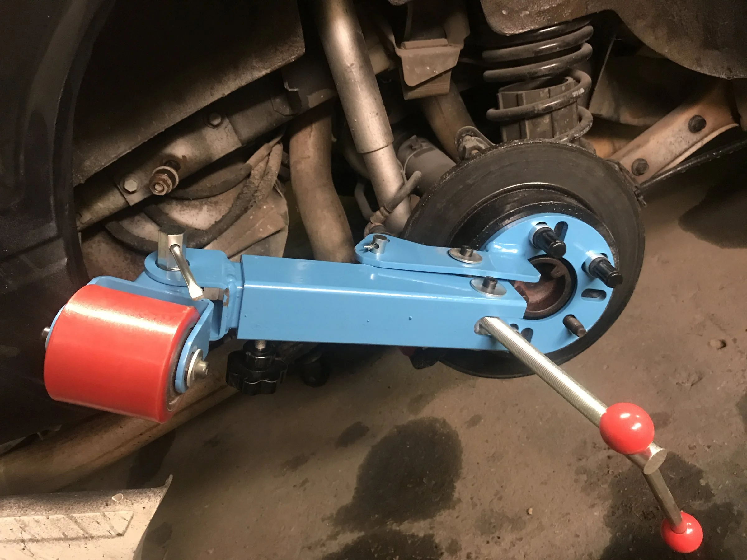

Ok. Started the drivers side. Spent about an hour on it. About half of that was figuring out the tool. It came disassembled and with no instructions. Took me a few tries to figure where the big cotter pin went. But the tool worked really well.... so well that I didn't think it was working at first. It rolls the lip without any movement in the quarter panel at all. I'll work it a little more but so far I'm impressed for the $39 I spent. Good thing I needed one more pass of primer.
