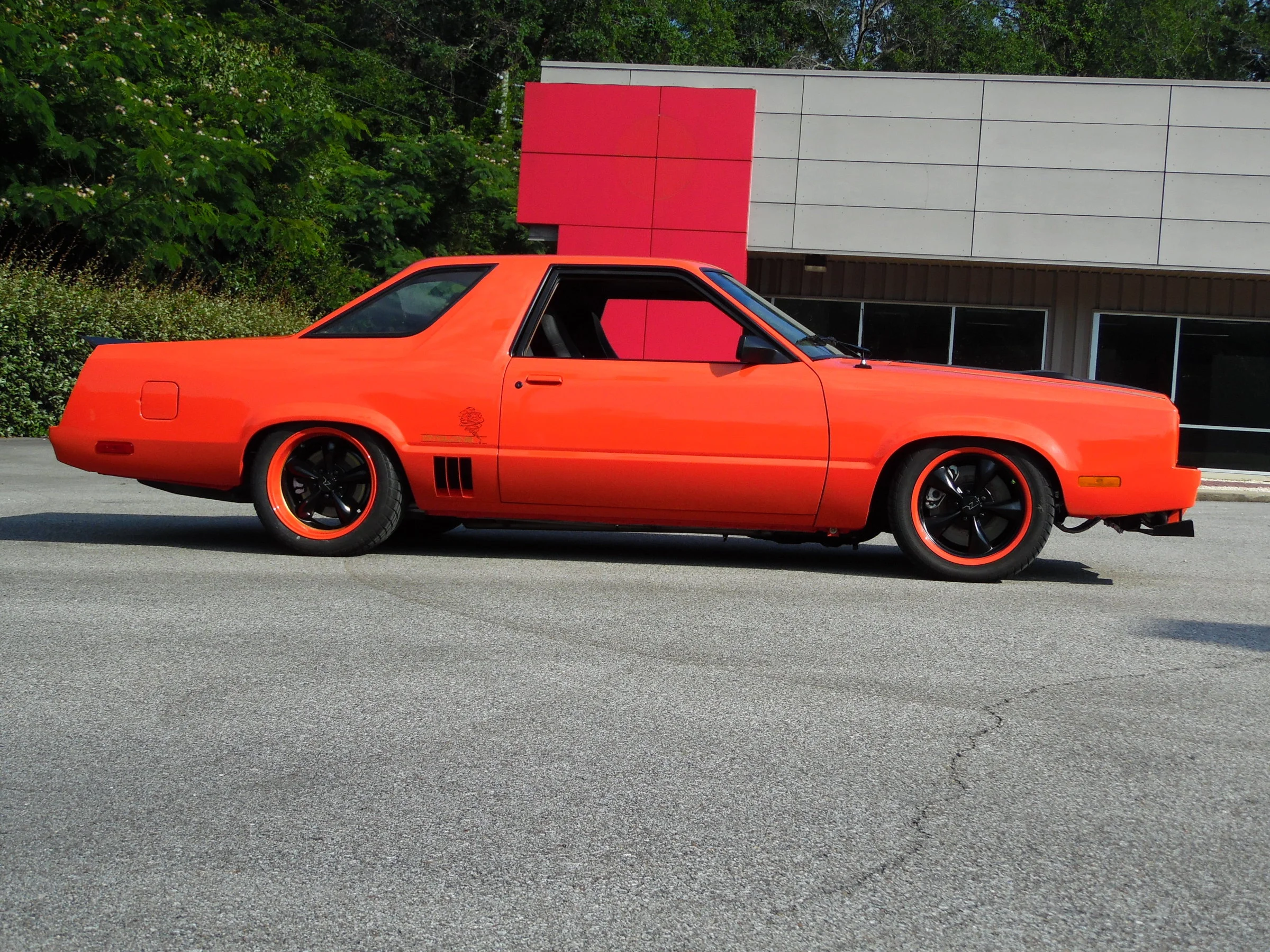

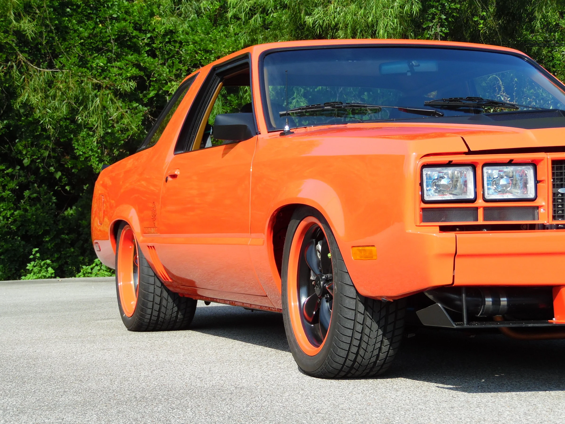

I see it as a"what have you got to lose?" if you do it now. Who cares how many other cars run what they run and get away with it? That'll all change the day you decide to run a set of ** insert size** tires, mounted to the wheel you've always wanted w/ a "Never fit in a million years" BS/Offset, that was just too good of a deal to pass up.
If you wait until after you've painted, then the whole paint job on the fender/quarter becomes an issue. Better to try and fix it now when it's only body work, then after, when it's bodywork and new paint.
Show me another Fairmont that can get away w/ this ride height,...and you'll find another example of a Fairmont w/ flattened inner wheel lips.
CarMichael Angelo
clearly, I’ve got something going on in that hole
SN Certified Technician
12,209
13,243
62
Birmingham, al
m.imdb.com
There is a lot of " give" w/o having to cut reliefs into the inner lip when somebody (me) decides to start smacking the inner lip w/a 2 lb sledge. It just takes patience, backing up the shiny side w/ some sort of sand bag/ shot bag, and doing it gradually. Ultimately, the only part that needs to be flattened is the top part of the lip where tire sidewall contact starts to come into play. Since my car is the only one where anybody offered up a "stance pic" I'll point out that you can see the flattening start to get more serious at about the 10 o clock/2 o clock in the arch of the openings.
To each their own though,..personally I'd take a flattened inner lip that can't be seen too obviously to a giant bite mark out of the tire sidewall that would be visible after the fact any day.
