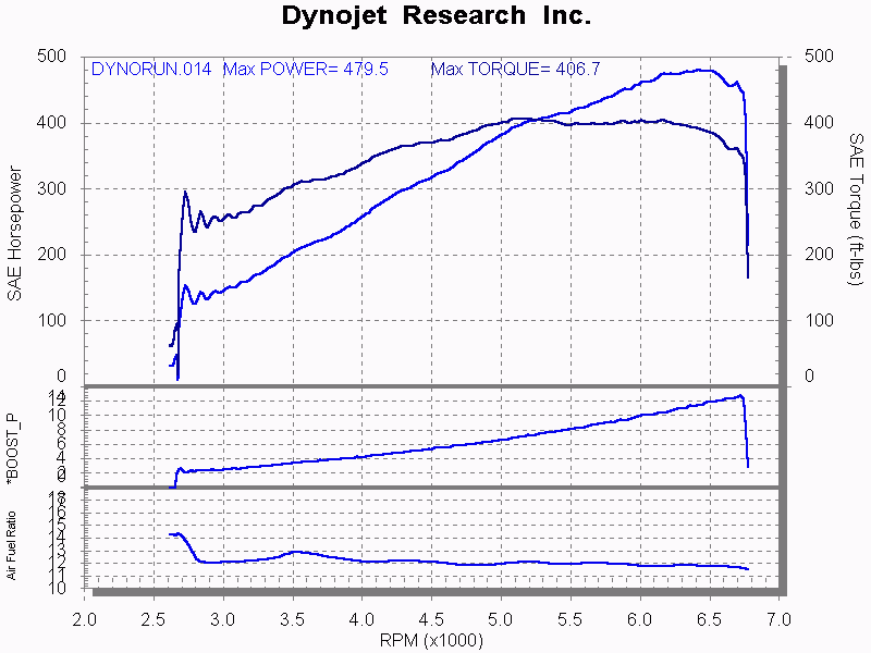

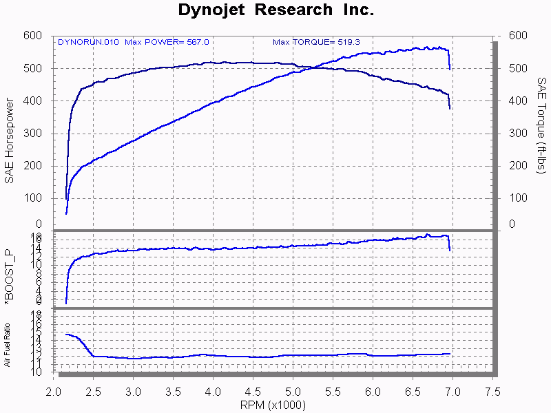

the roots type and screw type blowers both build boost in a linear fashion. boost pressure in these types blowers in predictable and constant. double the rpm, double the boost.
a centrifugal blower builds boost much like a turbo does, double the rpm square the boost.
the biggest drawback with the centrifugal blower is that the impeller turns up some serious rpm, and you have to becareful not to overspeed the impeller and its bearings. the roots blower builds more heat, reducing efficiency.

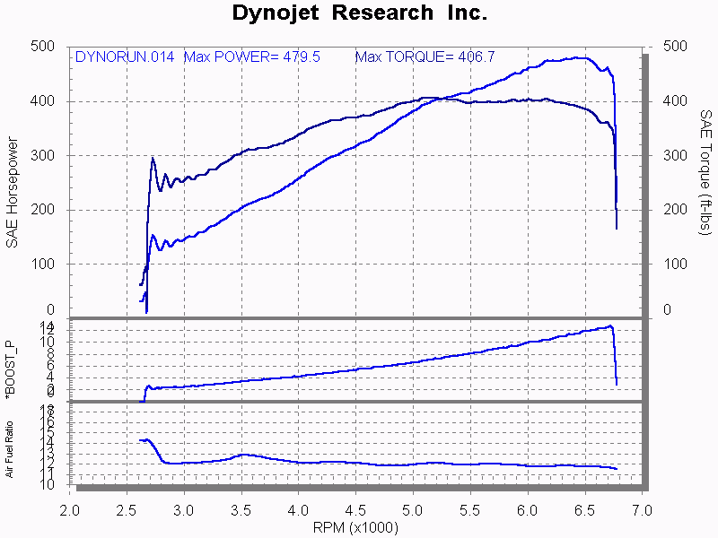

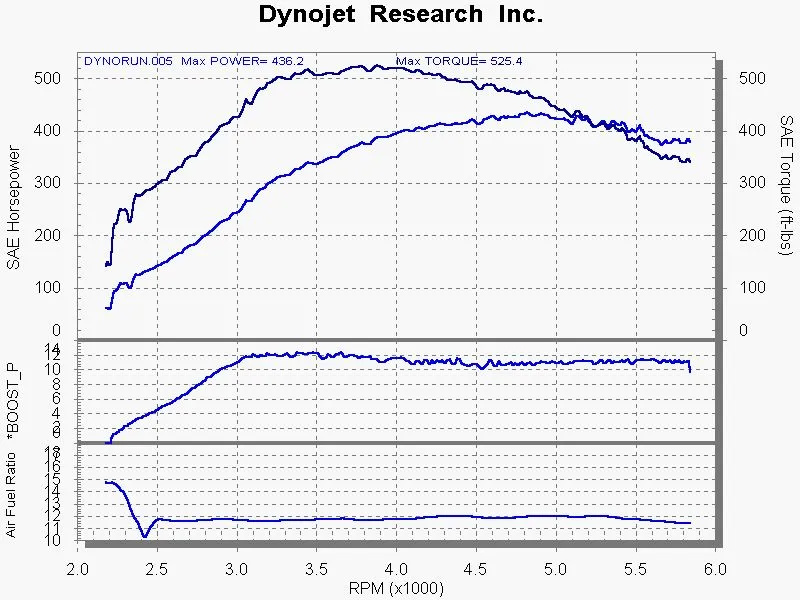

oh and here are some cool graphs I came across that compare boost between centrifical and roots
1st is the centrifical
2nd is roots
3rd is turbo
