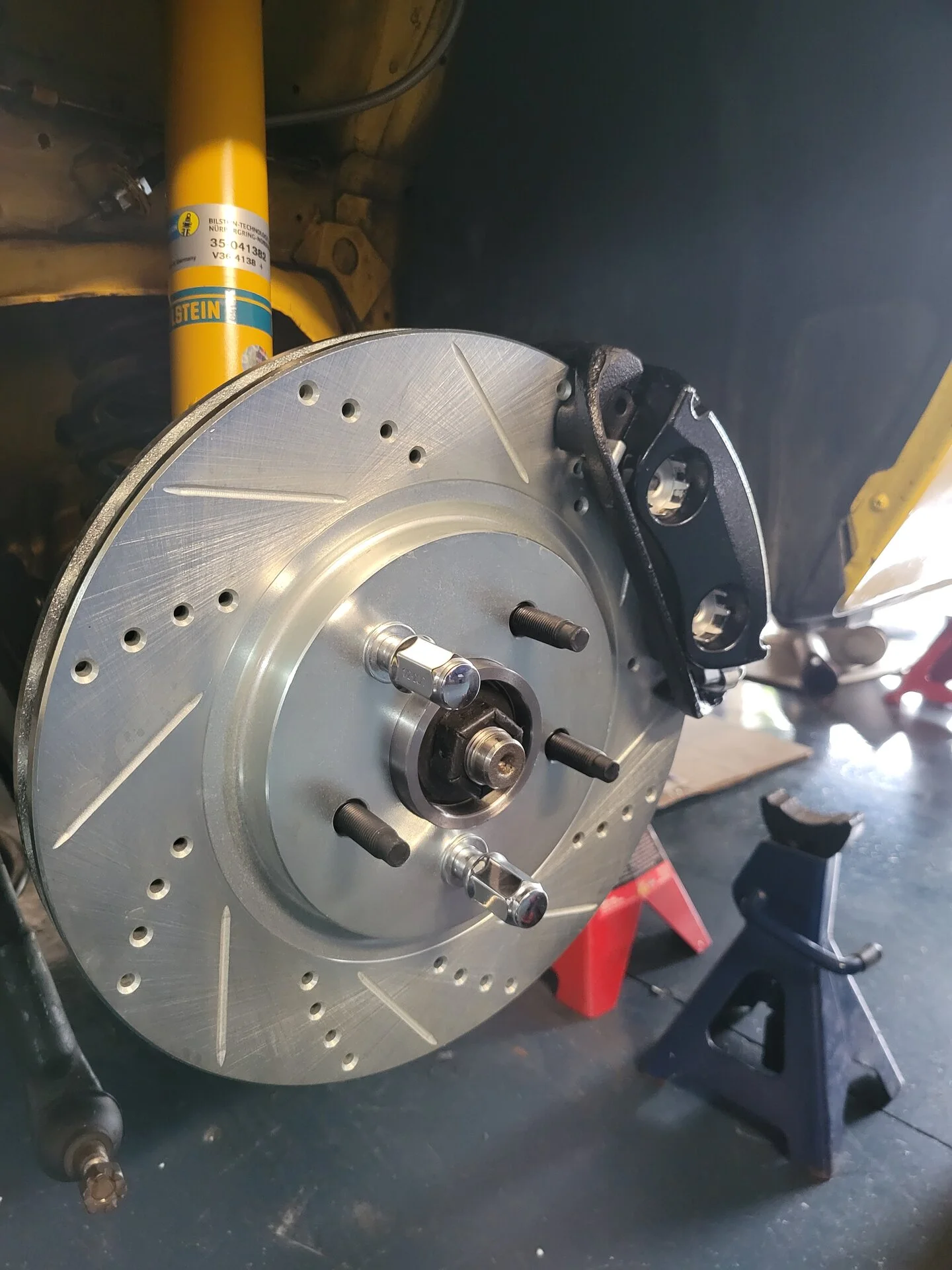

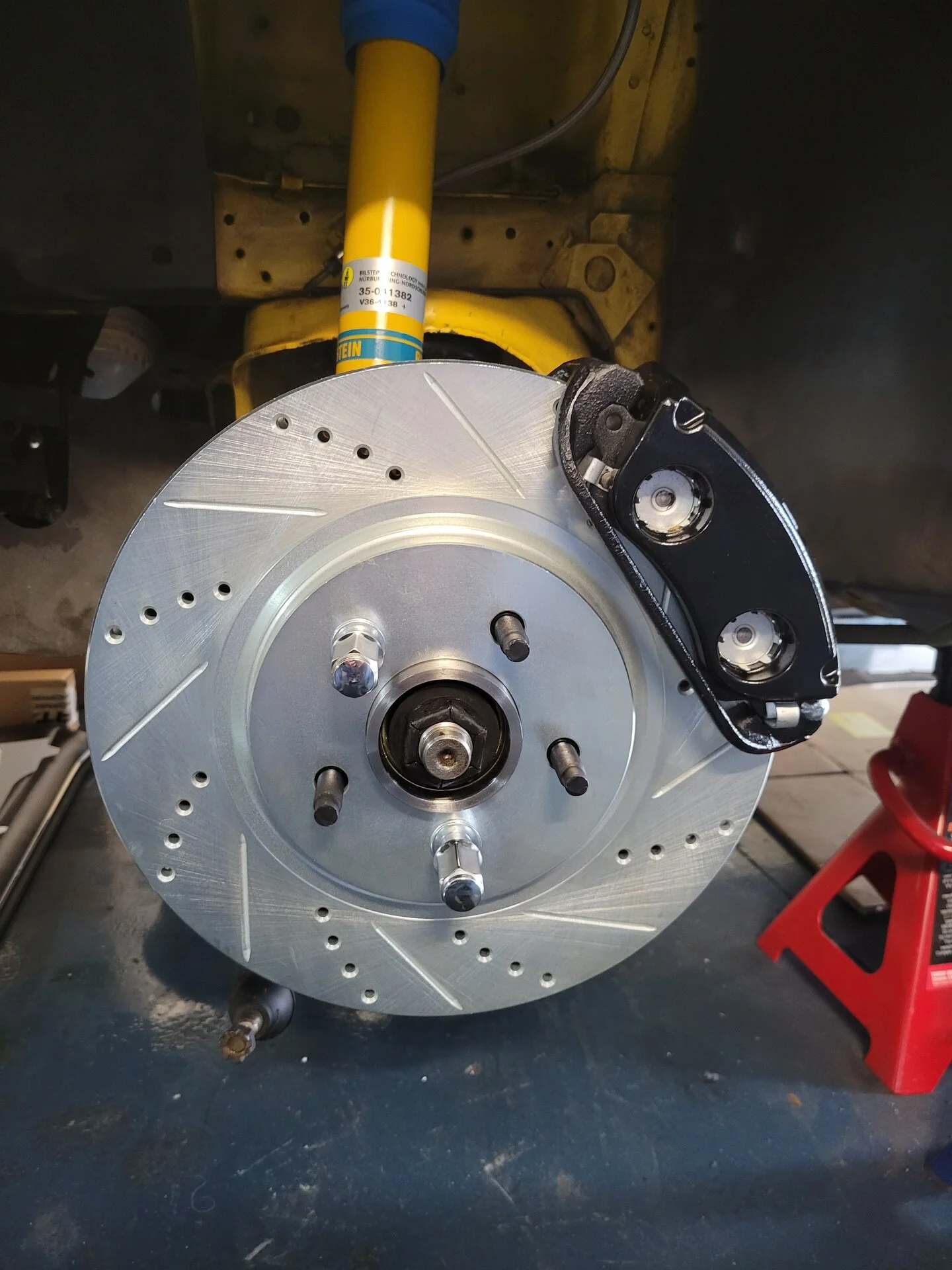

Mounted up calipers and rotors today, looking at the coverage of the pad on the rotor face it looks like width of the face is made for a bigger/wider pad or setup?
Everything mounted up correctly, but just concerned about the amount of rotor not being used /touched. Triple checking part #s, etc.
Rotors are from r1 concepts

Yes, it's normal for the 13" cobra setup to only have 2" or so of pad coverage on the face. Your setup is correct. It's just how it is.
That caliper was originally used in early 80's corvettes with a 12" rotor setup, so there wasn't much face to contact originally. In the 90's PBR redesigned the caliper to offer more pad sweep area for 13"-13.5" rotors and GM adopted it for the '97 Corvette. Ford stuck with the early caliper through 2004 and never made the change.
I actually run the new design PBR on my car. Baer used to make brackets for it, and it covers ALL of the rotor face which is what I like about it. Same piston sizes as the Cobra, but MUCH more pad area.

Thanks Mike, appreciate the information. Something to look at in the future then. I'll just need to quiet my OCD for a while (and swap the rotor since i realized once i took the pic that i had the wrong side on).. :doh:
Now to figure why the pad retaining pin was so tight.. probably need to take a small hole file and clean up paint a bit..
