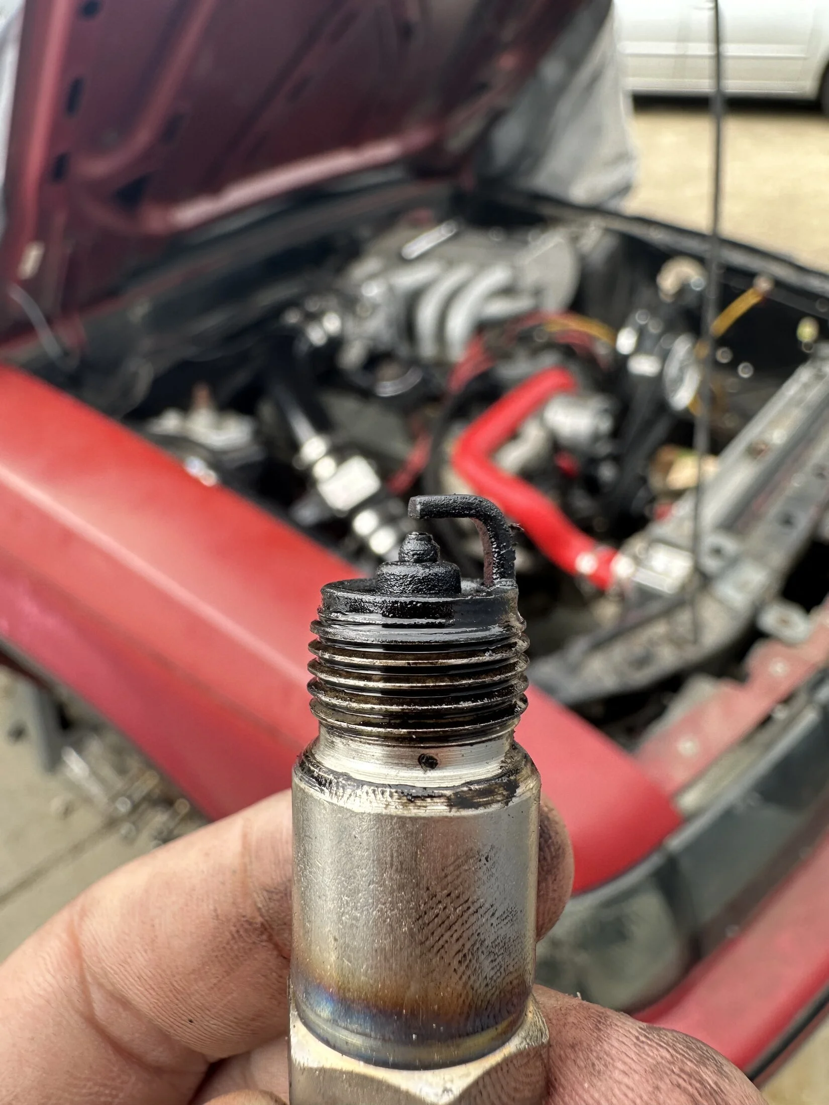

Plugs are wet and covered in soot, which confirms it’s running rich at least.

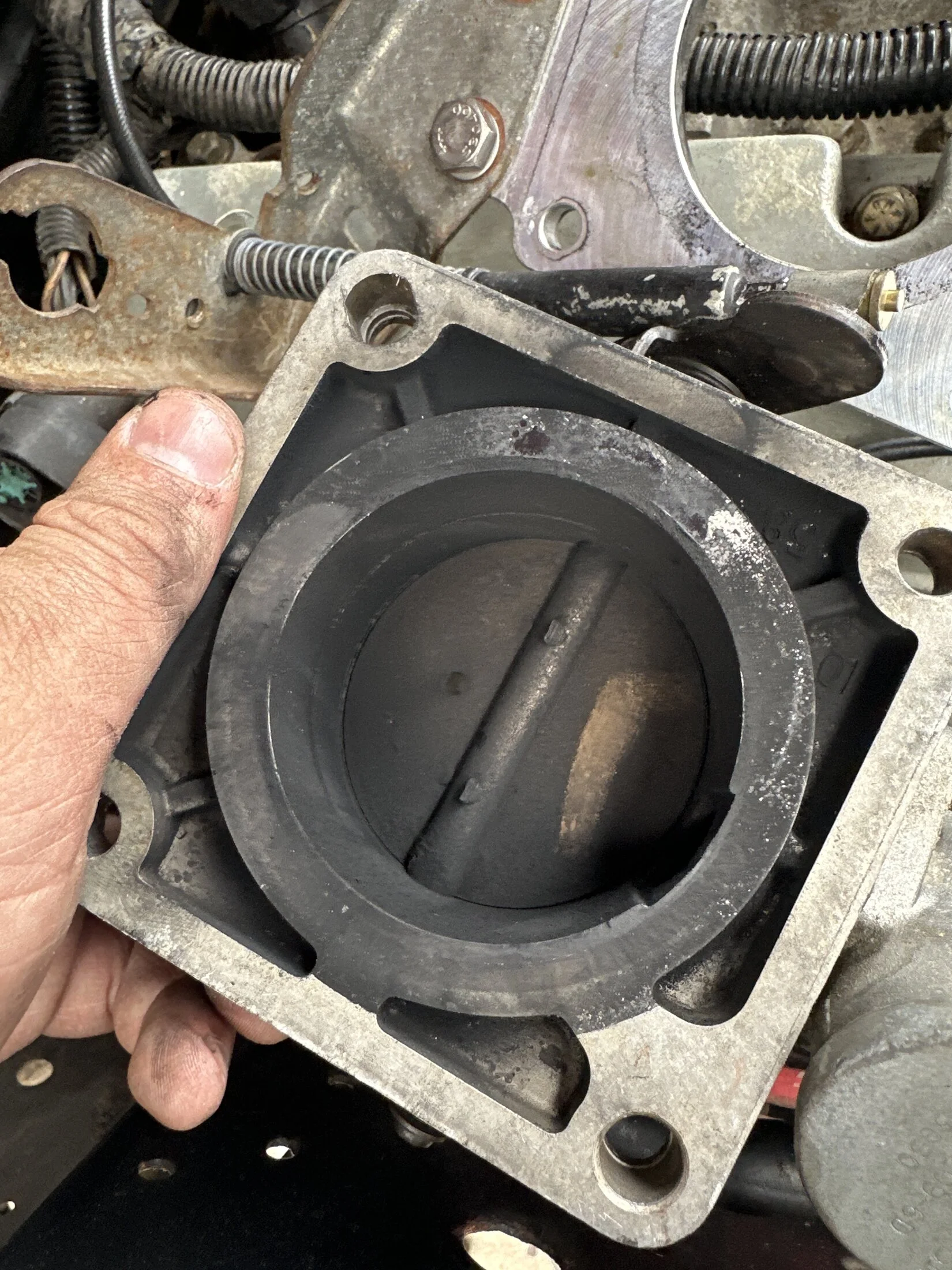

The injectors are just the bosh 19 lb injectors, checked the part number online and bought the correct meter to go with it.
The JPC intake is a custom one that was hand welded by that company, don’t know a whole lot about it other than it’s a speed parts company.

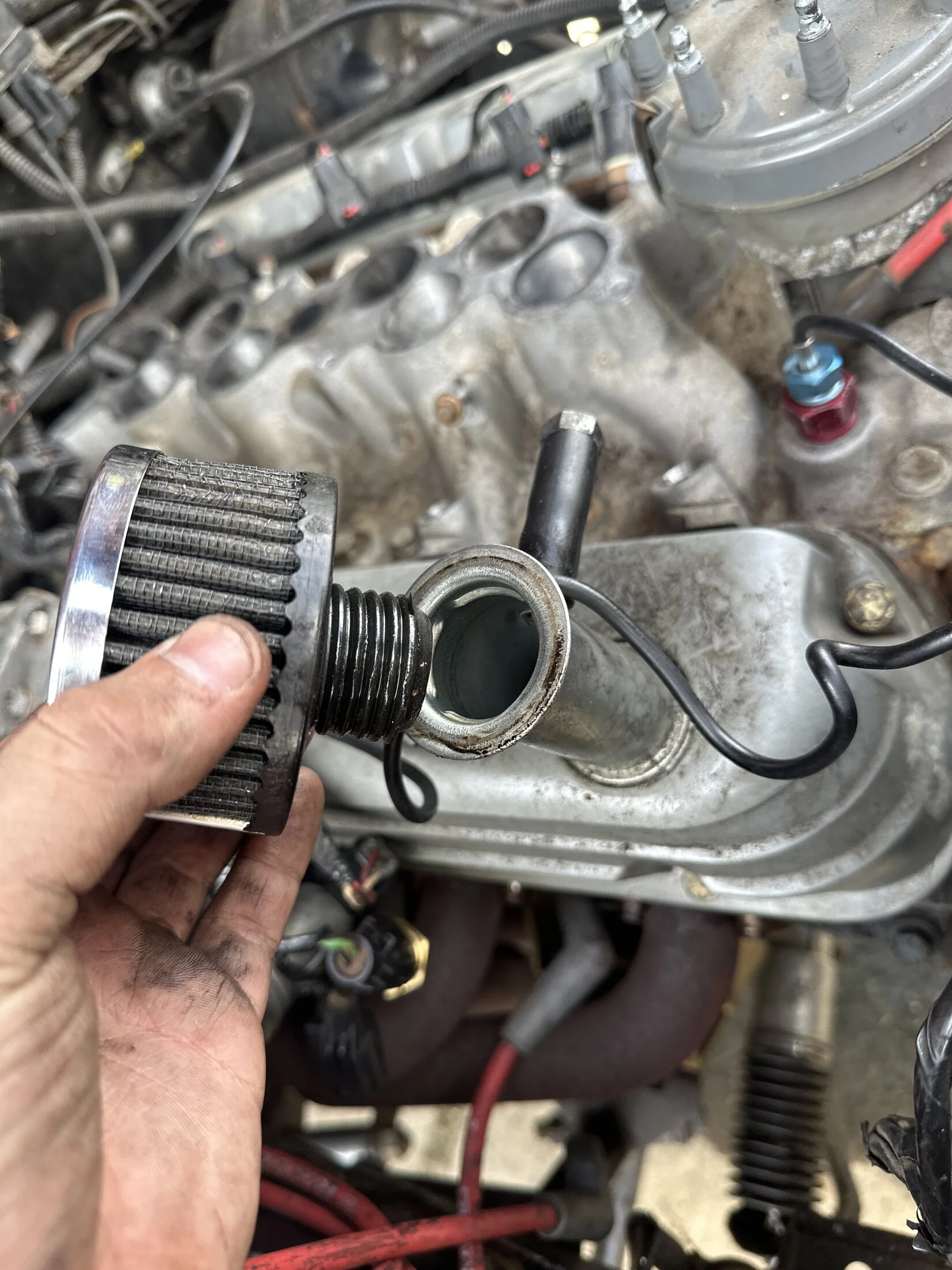

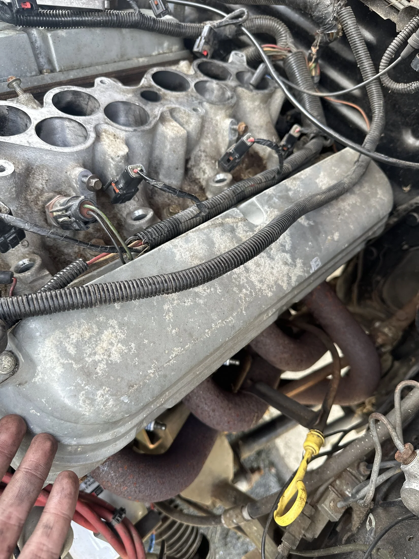

Ok... Do you happen to know if a high volume oil pump is installed?
Also.... Pull the PCV valve and grommet. Shake the valve and see if it still clicks.
Under the grommet, there should be a screen. Pull that too. You should be able to see daylight through it when you hold it up to the sun.
Once the screen is out.... Hold your tongue [just] right and get your peepers down that PCV hole and see if there's a shield still down there or if you can see all way down to cast aluminum.
PCV system has also been gone, you think there’s too much crankcase pressure and it’s going through the valves and into the intake?
