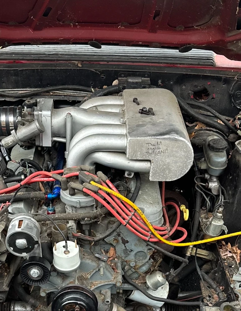

Lets get a pic of this upper intake......
Pic when I first picked it up a bit ago.

Odd setup, modified gt40 tubular intake, 19lb injectors, accessories deleted in a drag car which probably couldn't have been much quicker than low 13's unless they used nitrous. Also the heads look to be painted iron heads.
I can't tell the size of the TB or if it's stock in the pics, but there is no EGR spacer and the vacuum line has a bolt in it.
Then you have what appears to be an aftermarket fuel system with rails.
Not much of it makes sense, other than the idea that they slapped a bunch of parts back on it to sell it.

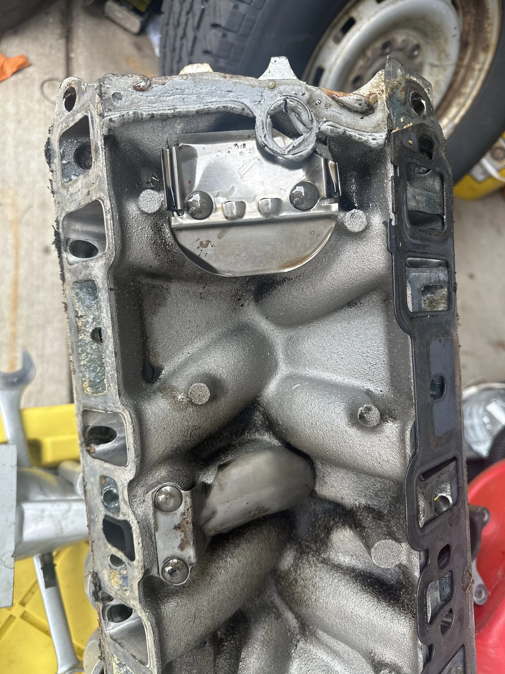

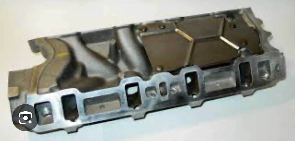

The plate he is referring to is a oil splash baffle, early intakes had a weeny little plate that was riveted to the bottom of the lower intake right under the PCV hole, I'll post a pic from the 'big screen' later, it basically keeps oil from being sucked up into the intake, sometimes, well as time and miles went by it was discovered as the oily crude gathered on the screen under the PCV, oil residue would traveled up the crudey screen and get sucked up into the intake so they put a longer baffle under there, like the one in the pic.
Only has this little one on the intake
At least you have one. It's really a moot point until you get it all hooked back up though. With the breather over your PCV port, I am relatively certain all that oil in the intake tract didn't come from there (unless it's been there a really long time).
So, with the PCV port vented to atmosphere, that still leaves us to figure out where all that oil in the inlet tract came from.
