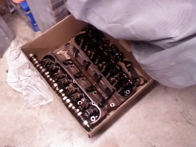

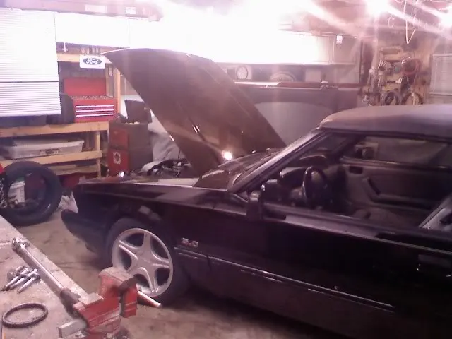

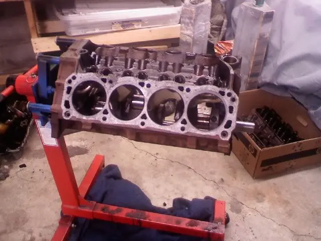

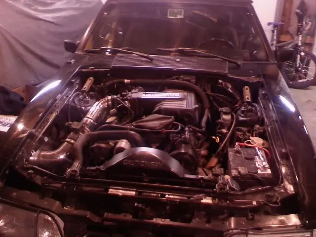

ok time for some pics.

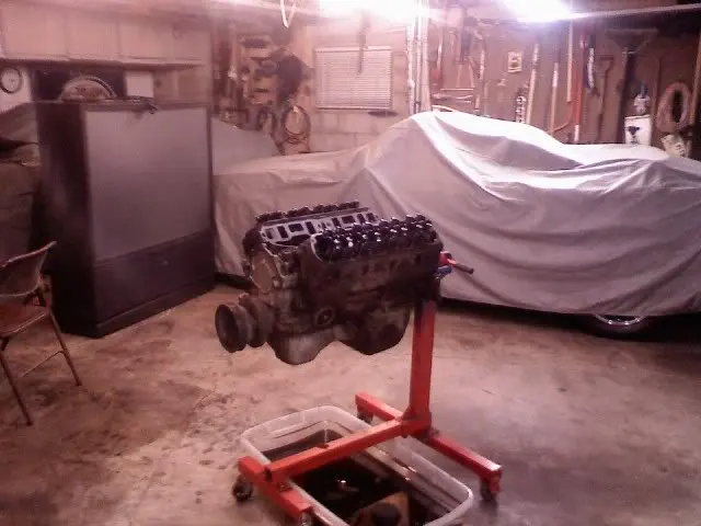

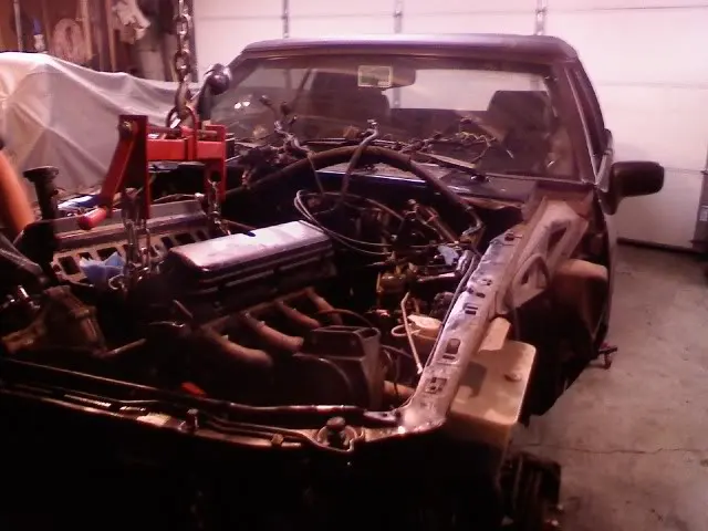

block and heads are out now. so i pulled the engine from the stang. now its time to start on the engine bay.

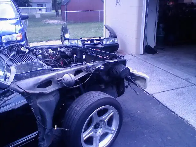

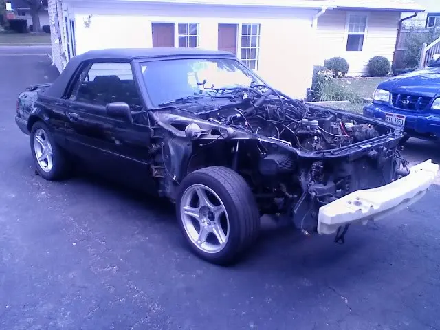

pulled the front clip of so i dont scratch the paint up.
how the motor out of the stang sits right now.

For 17 y/o....you do some damn fine work.

Ryan have you torn down that old engine yet (heads off) to see what the issue was? That old engine seems perfectly fine i wouldn't send it off to the bone yard. Try selling that ****zle. (unless you already are and i missed that post )
