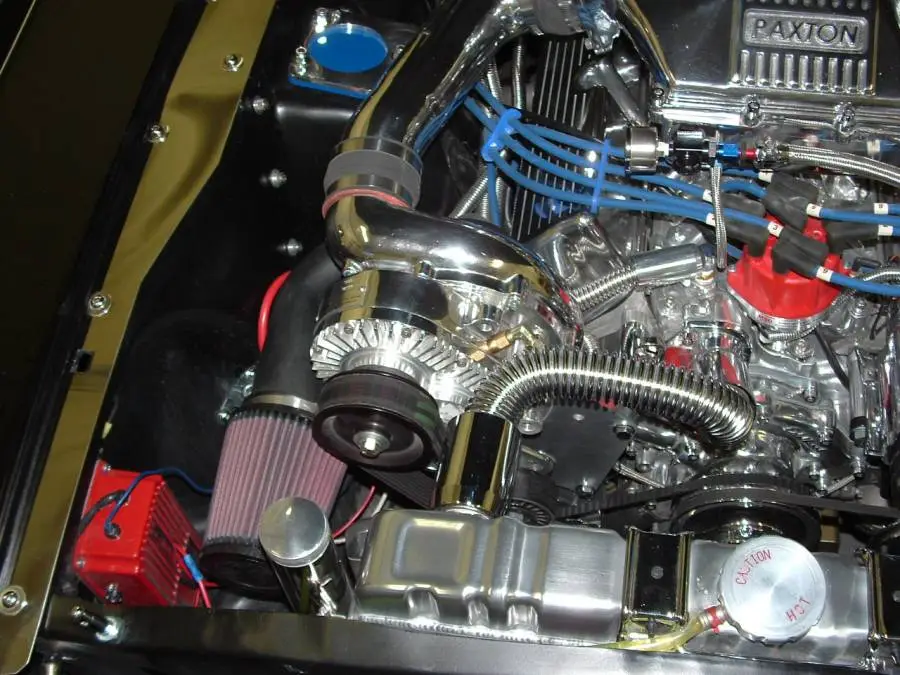

One cool mod we did to the install was using a late model Vortech turn tube to get cooler air. It uses the same filter.
Although it's not a cold air set-up, it gets much colder air than sitting right over the header.

I seen that on a web sight I'm assuming Mustang Depot I am definitly going to do that, when I first got the kit I thought it kinda strange that it oulled air in fron just above the headers, I ordered my new dizzy and new intake should be here tomorrow so hopefully I can get this thing going, nice setup there, looks very clean
Yea, I was seriously looking at that Vortech turn tube for the impeller inlet, because it clears really nicely, but I didn't like the way it pinches down at the radius either. I ended up making a 3" mandrel bent tubing that exits the rear of the battery apron, and then re-enters right about where your filter is also.
I'll find a camera and post a picture.
That's an awfully big pulley.....just kidding!! :D
It looks GREAT !!
N/A 80 miles on the motor, no smoke yet. We're temporarily running the brake booster with that line. The power brake booster and mc is being replaced next month the the JMC triple res. set-up when we put the TKO III in. We'll be there on Sept 9th for the install with John and the boys down at JMC. Aside from our business relationship, John and Julio from JME have become pretty good friends of mine. They're good people...
Oh, the pulley :)
Yeah were still runnin the supplied pulley at 7.5 lbs. They have a 10 lb pulley kit but we're working on hooking up what we have already. At this rate I would be buying tires once a week!!!
