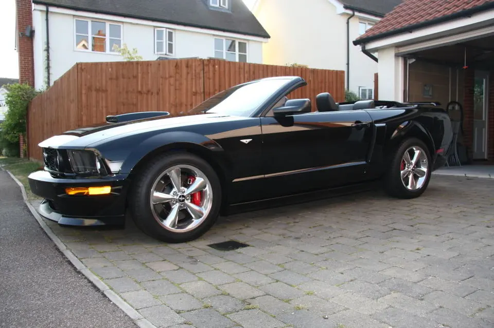

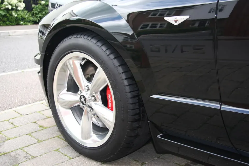

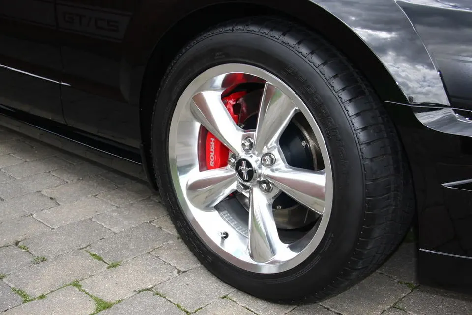

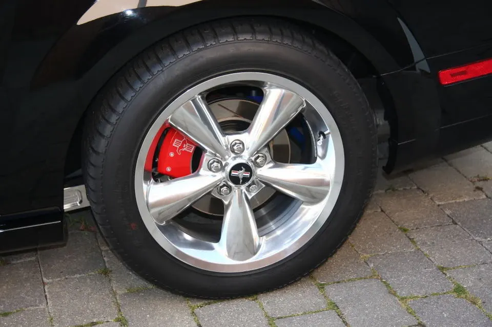

I fitted the Roush big brake kit which is also manufactured by Stoptech, but to get it to fit with my stock wheels (18" Bullitts) I had to fit 1" spacers. (See Pics)
I bought the spacers from Welcome to TC SPORTLINE ONLINE*** and the quality is awesome. They are hub centric and wheel centric, so there is absolutely no question of any alignment issues. They have their own studs pre-fitted, so you use your own studs to mount them.
I actually fitted them front and rear, just to keep everything looking uniform, and you would never know. The stance of the car is just perfect and the wheels do not protrude outside the arches.
BTW, if you do go for the Stoptech's, change the pads to Hawk Performance Ceramic, (I did) as the brake dust will drive you crazy!:D
