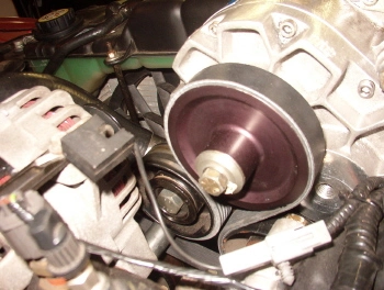

The belt routing on a new car with the reverse rotation blower has atleast 75% or more pulley wrap, look at how much the fox has....much less.
I just put a Sq trim on a 01 last night, I'll take a pic of the belt tonight so you can see the difference.
When I made the 8rib comment it was for the Fox style stangs.
I am running a SC-trim with GT-40 heads and intake. With a powerpipe it makes 6-7psi of boost, stock pullies. My friend also runs this blower and with only a change of the crank pulley to a 7 inch pulley (still using 6 rib belt) makes 10-11psi. It is definitely worth the money if you already have a btm, fuel pump, ect. If not you can pick you up a NOVI 2k cheap at superchargers4less.com that will come with those goodies. I have about $1900 in my sc-trim, MSD6-btm, gss340 fuel pump.
BELT WRAP ON REVERSE ROTATION
Here's a pic of a SQ trim on a 2001, notice how much belt wrap it has, over 80%.....
