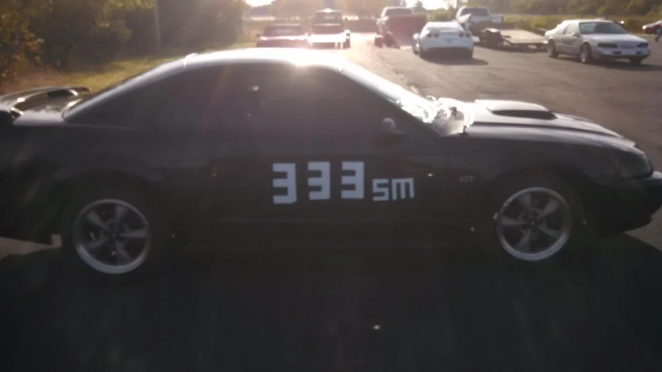

I wanted to write briefly about my most awesome first time experience with the SCCA and AutoCross on Sunday. I didn't know what to expect and I had a ton of butterfiles at the start of the day. The course was laid out beautifully and the car ran great. I should have a video up on youtube in a week or so for you to check out!

Part of the allowed modifications in this class is weight reduction, including the removal of the rear seats. The total for a SM RWD 4 seat coupe is 1800 lbs plus 200 lbs per liter. My minimum weight in this class with the driver is 2880 lbs. 1800+(5.4 x 200) At a stock curb weight of 3305, the old girl has a bit of a diet to go on to loose the extra 500-600 lbs depending on what I eat for breakfast.
