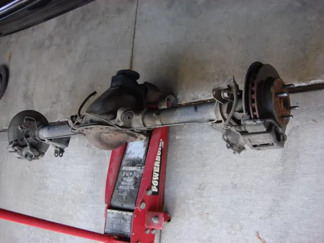

Nice. Those the 38mm or 40.5mm calipers?

They are off a wrecked 04 Cobra so the 40's

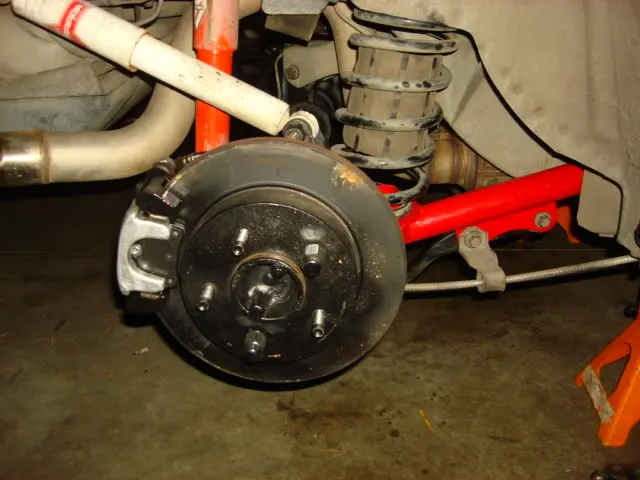

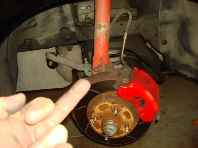

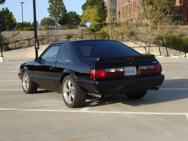

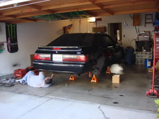

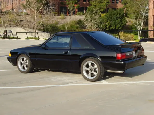

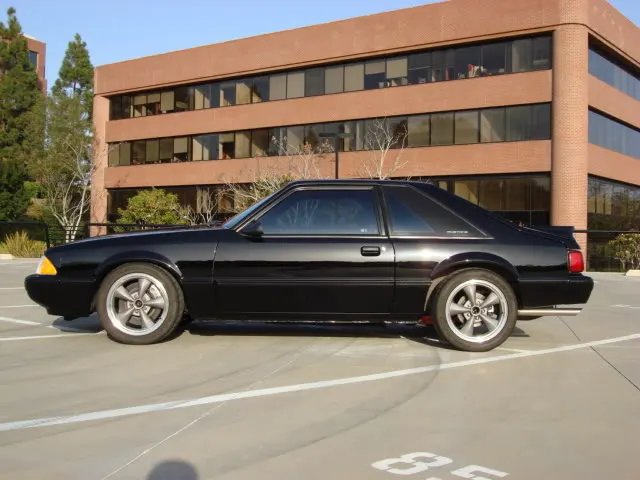

5 lug swap half done!
GroverDill
GoldMember
Aug 18, 1999
5,442
1,490
214
Demotte IN 46310
Mar 20, 2010
#124
  • Mar 20, 2010
  • #124

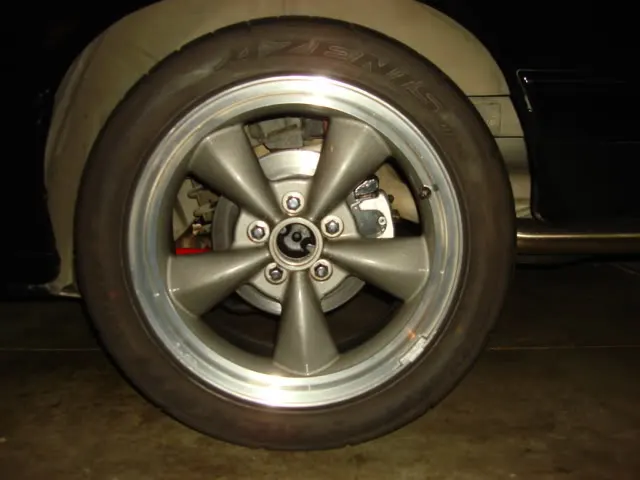

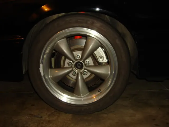

I like the Bullitts on the car, just need some center caps. More to do tomorrow as we have a bad booster (I think). The pedal is super hard, same if booster is plugged into vac or not. Car at idle, pull and plug vac from booster car idle speeds up and smooths out.
So plan is to run these wheels for a while, then change up with the 96 Cobras when I get tired of them.

Nice! the bullitts look right at home on there!

looks great. i have 2 cobra center caps. if your not into the cobra **** i understand but i have 2 caps id be willing to let go for cheap.

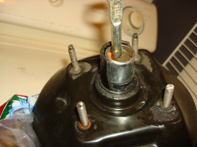

Sadly I think the booster is bad, the pedal is WAY too stiff

New booster in and damn the brakes are good. Once we got the old booster out we see it got broken during install, new one fixed it right up. Dare I say the brakes are a tad on the touchy almost over assisted side now.

Here is what broke on the booster, while fighting to get it in.

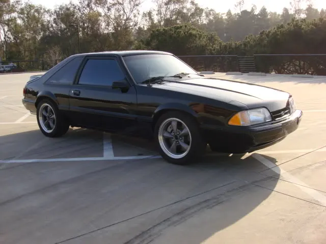

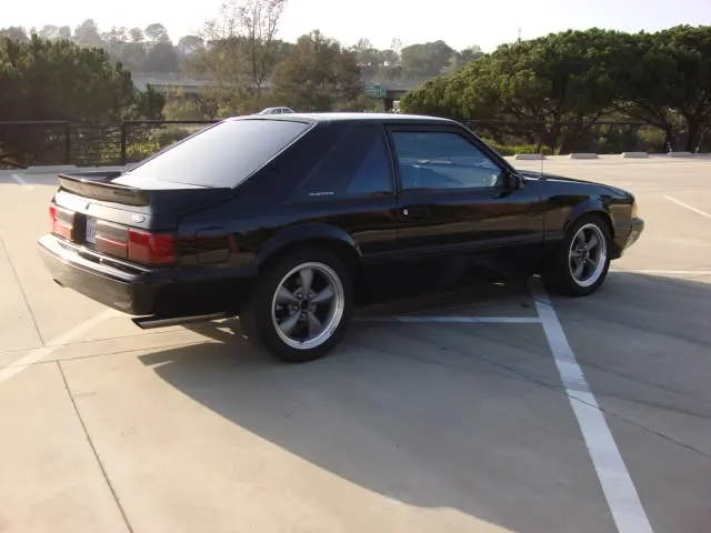

I like the bullitt wheels on there.
As of right now i have 3 sets of wheels for my car...not sure which I like the best now. My '97 Cobras, a set of 03/04 bullitt wheels..or my new polished 01 cobra wheels.

Agreed on all 3, the polished 01's would look good against the black. For now the Buillitts will stay.
I plan on staying with 8" wheels since it is my daily driver and I am using 03 front spindles and 95GT rear axles.
