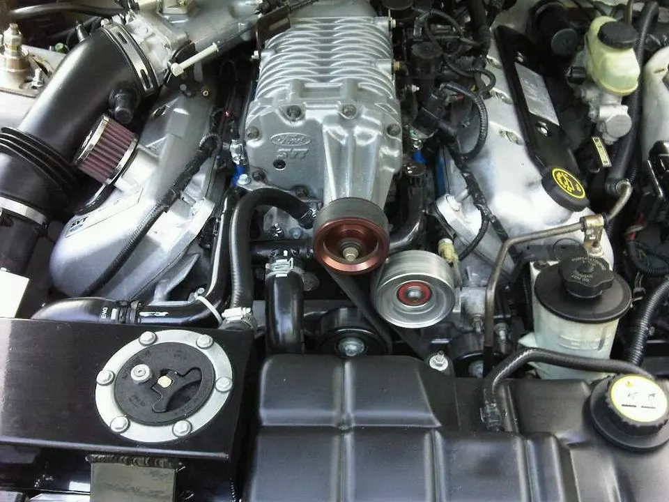

more info later on if anyone is interested... :D
alright, you've suffered long enough...
-1999 Mustang GT (35th anniversary, but who cares)
-2003 Terminator motor swap with 17k miles
-Amazon 3.0" inch pulley
-UPR auxilliary pulley (tensioner)
-Art Carr C4 tranny and converter, 4000 stall with reverse manual valve body and trans brake
-SFI flex plate and bellhousing
-455hp/457tq (on a safe 93 octane tune, 12.5 lbs of boost)
-QA1 Tubular K-Member
-Manual steering rack
-Complete Mach 1 brake swap
-Mach 1 Grill Delete
-Eibach Drag Springs
-Lakewood 90/10 struts and 50/50 shocks
-air intake shield with velocity filter
-Subframe connectors (bolted and welded)
-A/C delete
-Mishimoto aluminum radiator (2 row/3 core)
-LFP dual-bipass heat exchanger
-big aluminum expansion tank (black powder coated)
-custom aluminum driveshaft
-UPR upper and lower control arms
-solid rear axle w/31 spline and 3:73 gears
-MAC Prochamber w/MAC catback and 3" chrome tips
-Braille lightweight race battery (17 lbs)
-Procar Scat racing seats
-Cobra R 3" fiberglass hood
-Cobra trunk lid
-black Saleen replicas (87-93 style) 17x9 w/Nitto 255/45/17 and 17x10 with M&H 325/45/17
drag radials
car went 11.20 @ 124 mph spinning through 1st and half way through 2nd apparently... but
i'll get my own timeslips to verify :D
