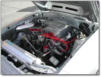

For the comment about the Holley SysteMAX II being too large, it's all in the combo. My own old 302, 8.8:1 comp (notch pistons for cam), Holley heads, AFM N-61 cam .544/.568 228/236 110, stock internals, long tubes, full exhaust, 75mm TB, 80mm MAF, 4" Power Pipe...made 340RWHP and went 11.7 @ 116mph trapping only 5200rpm (I needed more gear then the 3:73 I had) I think with some 4:30's to take advantage of where the cam made power it would have went 11.40's. I had the 3:73 because with a 175 shot the car made 540RWHP/742RWTQ and trapped into the 6500 range @ 133mph+

are those numbers on a stock bottom end in your sig? what kind of cam are you using? headers? you can pm me if you want.
The bottom end is stock. I'm using a xe276cam (224/230-112). BBK long tube headers. My build is similar to Ricks's 302. 75mm tb,4inch power pipe.
When I was doing the motor, I almost fell into the holley is too big trap. But after doing some research, I took the gamble.
I dont have track times yet though.
