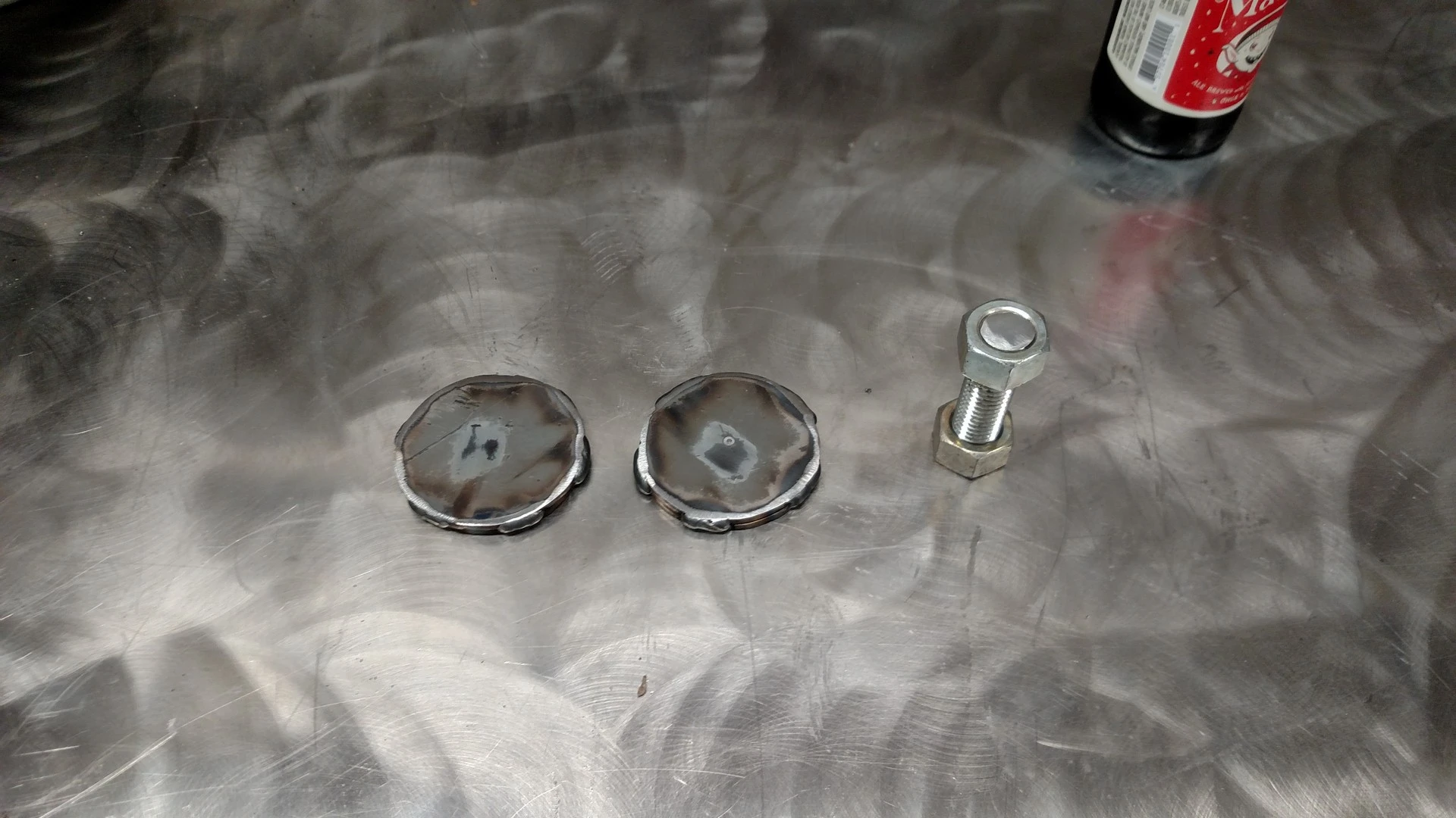

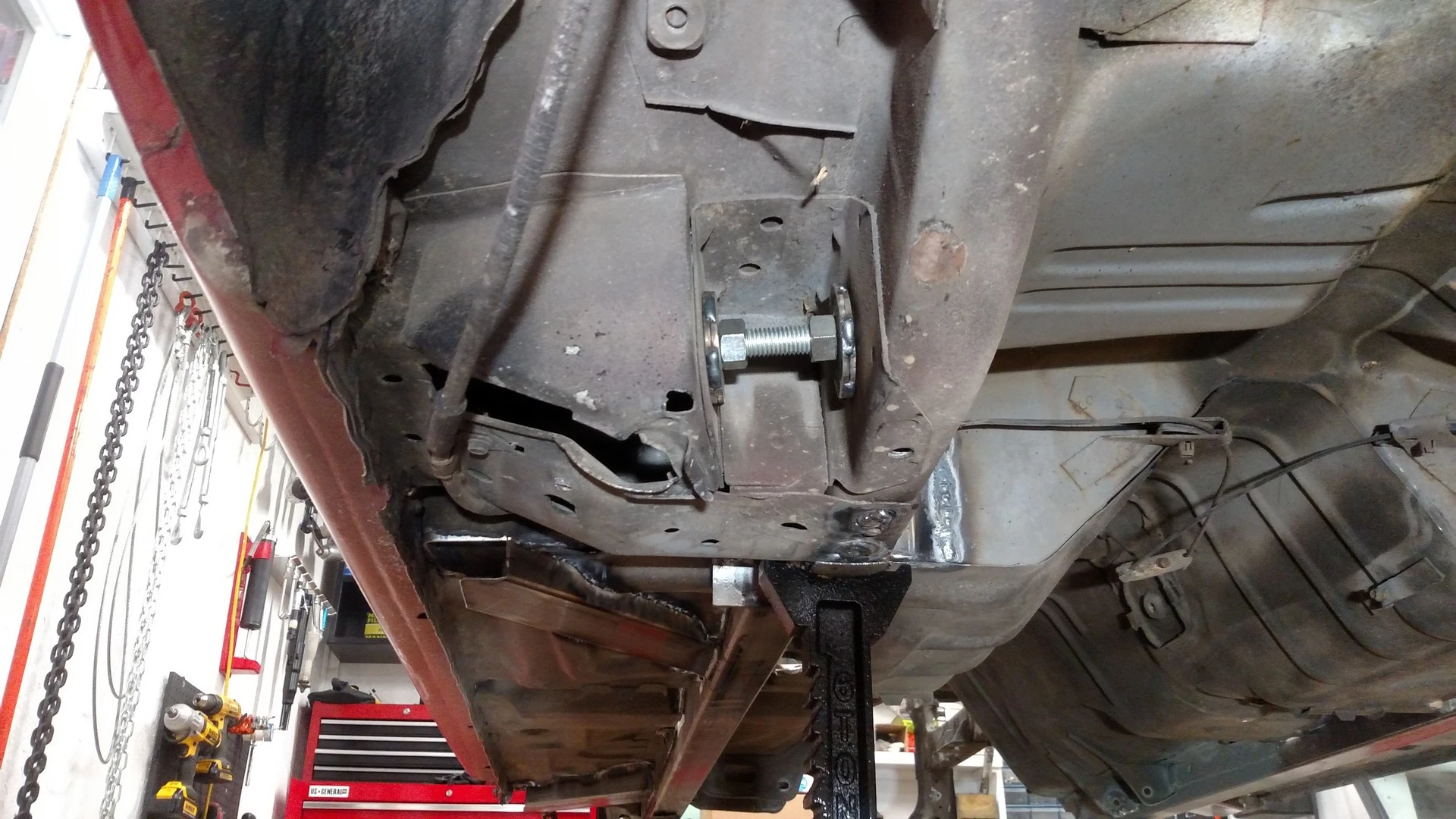

Been working on the IRS hard tail mount as much as I could this week, which wasn't as much as I wanted. Wife's dad got smacked by a widow maker on Monday so she's been busy with visiting him in the hospital while I've been taking care of everything at home, after long days of work of course. Anyways,
Built a torque box spreader to open the torque boxes up a little. They just needed a little spreading to allow it to slip in easier.
