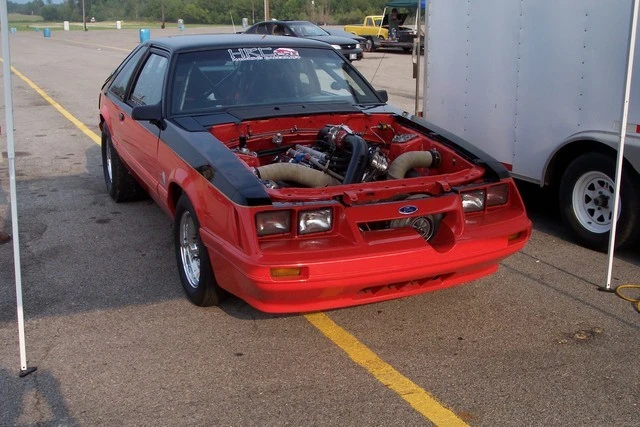

The 393 powered jap car in my sig went 8.80's. it was the slowest car in the field in 2003, I broke the 351 block trying to lean the thing out for more power...( pic is of me discovering aluminum all over my plugs)
THAT was NOT fun.
Because I never learn the first time, in '06 I backed that car up with the meth fueled orange/black 86 w/95mm 363.
Car ran 5.20's/8.10's, and was still the slowest car in the NEW field. ( rule change over winter when I was building allowed 600+" and only penalized 200 lbs extra weight) Because of meth fuel, had to wear -20. ( like snowmobile suit)b
Track temps 140+......Meth tuning learning curve resulted in two sets of trashed TFS R heads..and even when everything was working, the cars going like 160 mph.....
(This is after Melted head #2)
