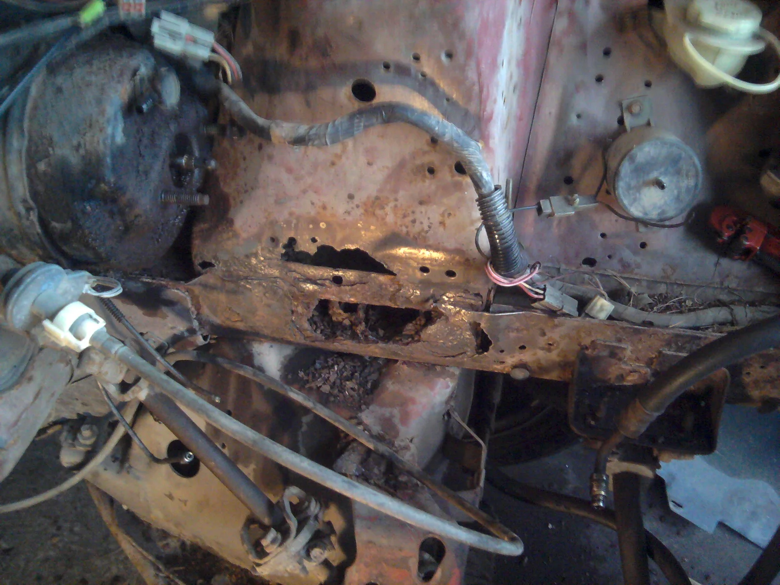

This will be a long shot, but I've had something similar in a one of my old II's. There was a "loose" upper control arm nut. I quote that because it wasn't loose per se, but it was failing to clamp onto the frame rail for whatever reason. My symptoms were a little different, though. It would drive fine no matter the speed, but if I hit a bump hard enough, the UCA would shift, causing the steering to jerk. This is why I gave the suggestion of checking the LCA mounting bolts.
How about the K member mounting bolts? Or the frame rails that the K member is bolted to? I'd suspect those could be an issue. There are many of us who have had to repair/replace those frame rails on Fox cars, it doesn't seem out of the question that your car may be suffering from that fate....
Here's a pic of my old 84 vert that I had to replace the rail for an example. There are 2 bolts per side - imagine if those bolts rusted enough that they gave way.

thanks for such an insightful reply my friend! i’ll check out everything you mentioned, although surprisingly my car is pretty dang rust-free. if either of those aren’t the issue, where would i start looking next? should i replace the steering rack first? i’ve also heard that driveline u joints could cause shaking, but it almost certainly feels like it’s in the steering. i also don’t want to fork up the cash for road force balancing if it’s unnecessary, but i’ve read that as a possible fix as well. thanks again for your advice
