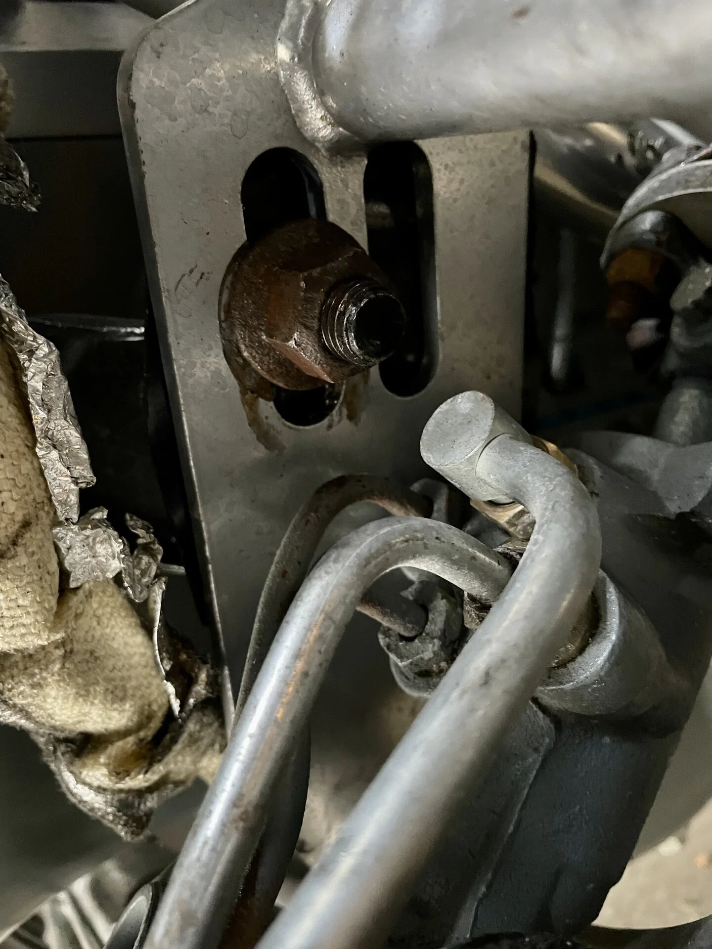

Noobz347 said:
I think that is the first time I have ever seen or heard of an engine twisting in the mount.
I mean... I could see if the bolts were loose? Even broken mounts still have the bolts and top plate still glued to the engine. Weird
I hear ya but that's absolutely what happened. theres even a scrape as the nut slid down on the drivers side and up on the passenger side. to be clear this was the stud that goes through the K

Boostedpimp
20+ Year Stangneter
May 8, 2003
1,451
493
154
NJ
May 13, 2022
#742
  • May 13, 2022
  • #742
I've never heard of an engine sliding loose like that in the kmember
Same here but it happened

Just use fire to make the engine and K member one piece and no more problems

It was definitely twisted in the mounts. I helped him get it straight again. I suggested welding up the slots in the mounts.

Here’s a picture to show you guys. This time I made them as tight as I possibly could. I still feel like something filling that slot would be helpful.

Just ditch the mounts and go with a motor plate
Right!! lol
