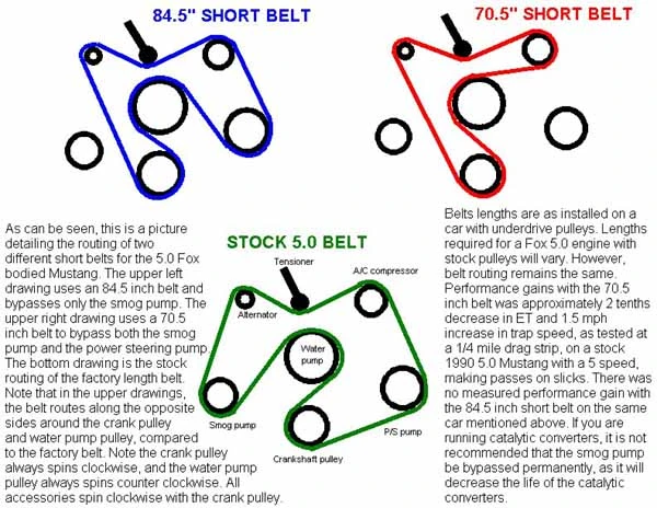

This should help a little. Don't have part numers though.
As I thought the 73.1" was a perfect fit for anyone looking to do the same. :nice: Mind you there'll be some stretch so you can go 72.8 - 72.9 but the 73.1 will be easier on the altenator. The 70.5 shown above in the 'red' example must have been drawn up just before that guy was karted off to a rubber room :notnice:
