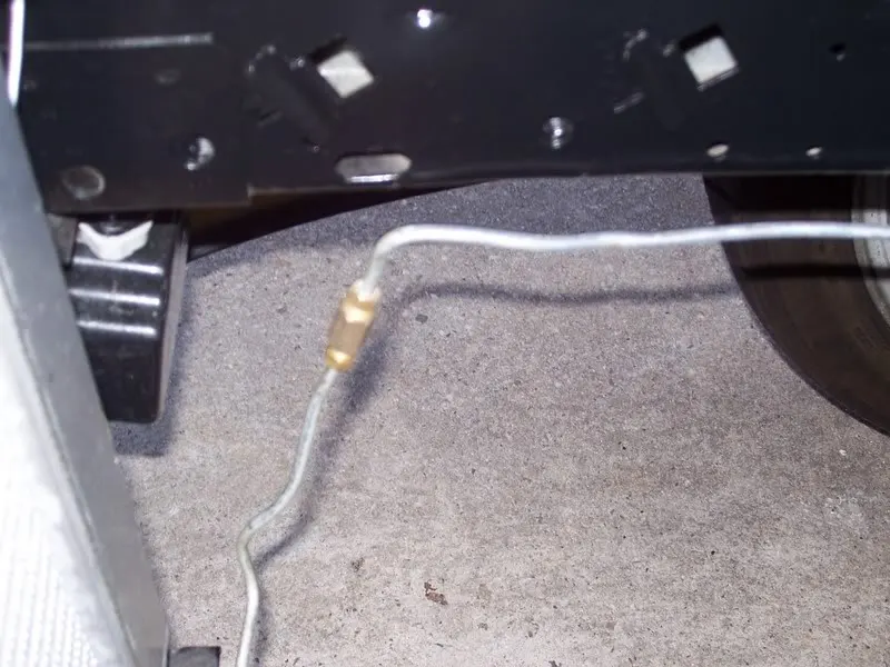

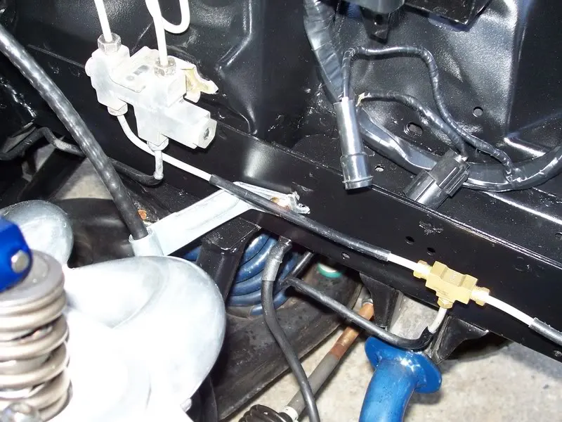

i ditched mine and haven't looked back
i deleted my ABS awhile back so i figured i would post up pics for the rest of u guys to see since this seems to be coming up alot lately. i deleted mine to clean up the engine bay and i never drive my car in the rain. once deleted, the bulb wont come on. a few things to know.
-i didin't have to buy any extra line, i had more than enough left over when i was done
-i spent about $5 in parts (a 3/16th tee, a few 3/16th tubing nuts, and a union)
-this was very time consuming
-requires the use of a double flaring tool. i'm not that great at using it so it took me some time and practice to get the flares right
now the pics. in the first pic u can see the tee i put in. the line coming out of the bottom port of the tee goes to the l/f wheel, the other line is run like factory, down and under the radiator, to the union u see in the second pic, and then to the r/f wheel. the line for the rear brakes i ran from the proportioning valve, down the drivers side of the car, to the rear where it tees off to each rear caliper.
