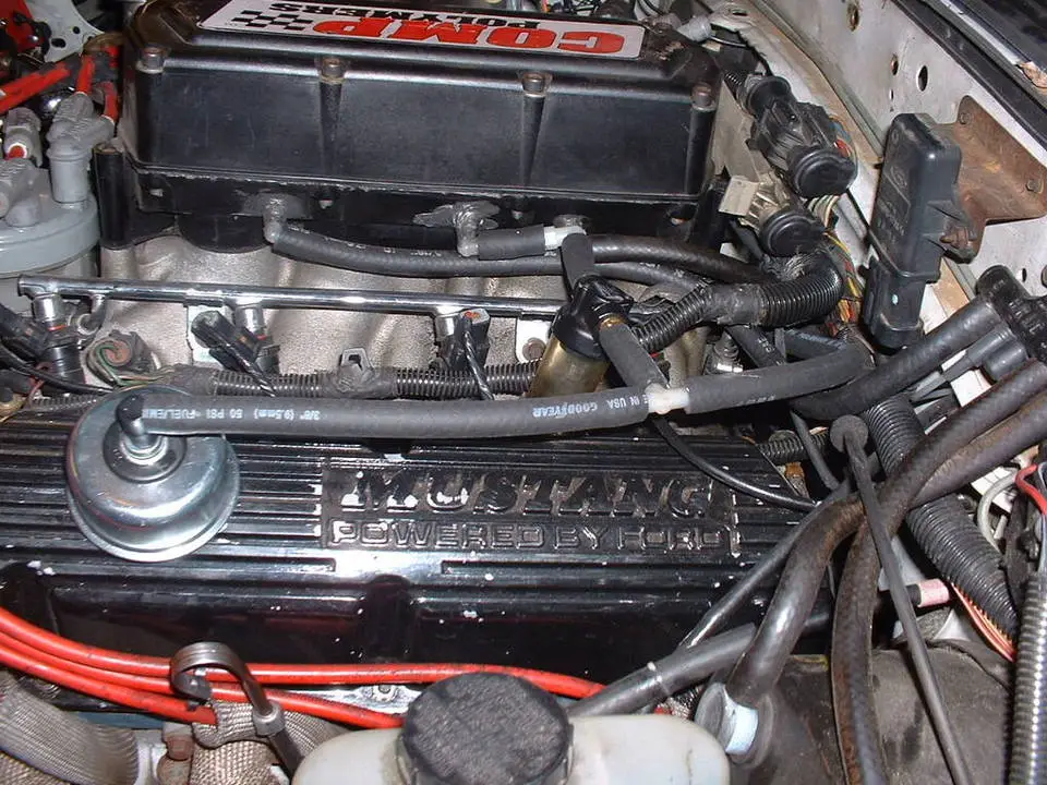

Here is what I did in order to have a second vent location on the drivers valve cover.
thats awesome, i like that idea. I was thinking to do that to the one that goes from the oil fill to the tb. I noticed oil gets by there as well.
This could be a different issue though.
Do you have a baffle on the inside of the valve cover? You can tell just by looking down the oil fill neck. If you see the rockers, then you don't have a baffle.
The baffle keeps oil from being thrown up the filler neck, where it can then get into the intake.
A separator would probably still help, but a baffle is a better way to do it.

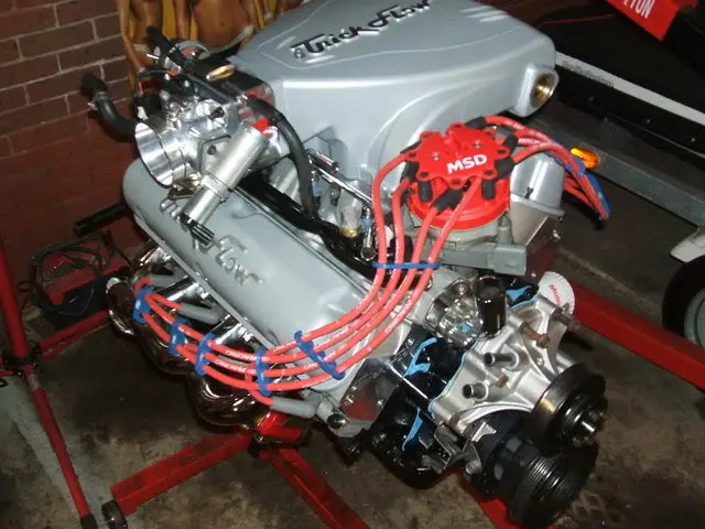

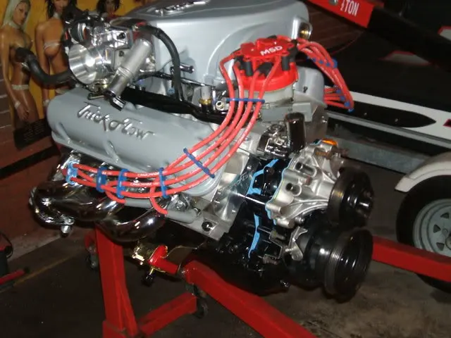

My engine is still sitting on my engine stand as shown. The top end kit i bought requires you to make a hole in the valve cover for the oil fill kit. I never looked but now that u mention it, I doubt it has the baffle. If it does not have the baffle would u recommend the oil seperator there too, or is it a waste? Heres a pic. Thanks
The separator is a short term solution.
It will fill with oil, and need to be emptied on a regular basis. I was having to dump mine out twice per fuel tank.
The separator will help with the diagnosis, and help get the oil flow under control, but it shouldn't be viewed as a permanent solution.
You need to have the proper baffling installed.
