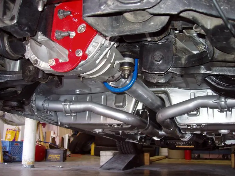

I've had the question asked about 300 times so here's what I did...
The Dr Gas set-up is all mandrel bent. I would have used it but the TCP Center section was in the way. So we used in-line flowmasters and just bent the pipe out to the side. I ran it right behind the outside sfc. I'm pretty sure I can get some cal tracs under there with a little massaging!

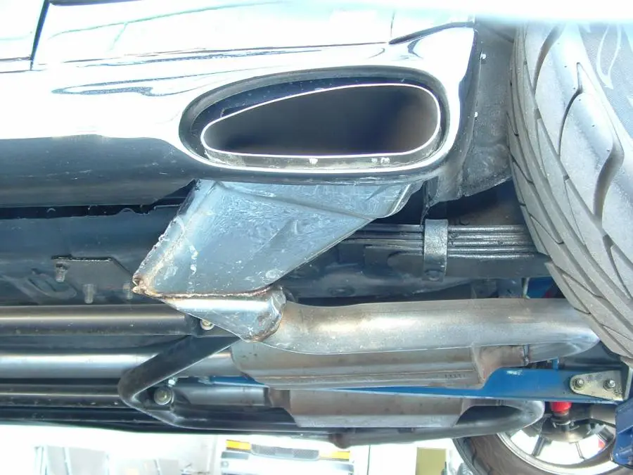

For SFC's, you have several options: the best is thru-the-floor SFC's - strongest & no clearance issues (also hardest to do). You can also run a setup like MDJay pictured, or Spintech sells both oval tubing & "clearance tubes", which are dimpled for SFC clearance.

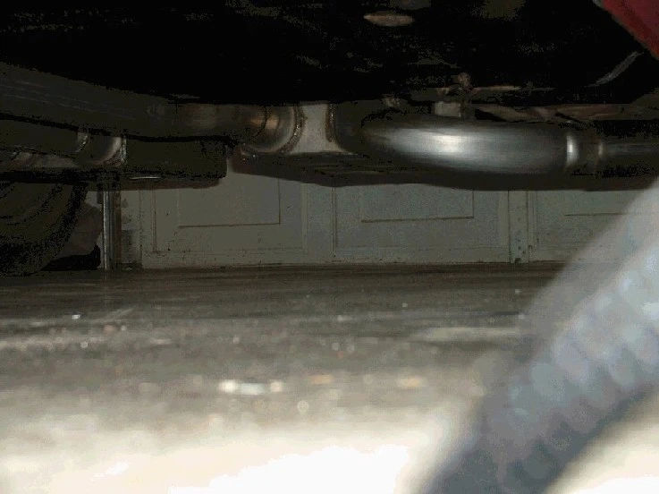

question for mdjay: with your setup would you have clearance issues with shelby underride bars? I like the idea of running a flowmaster as they don't make a inlet/outlet same sided muffler. thanks.
They are a tad loud, but it is only a week end play car, so not bad. Those are Dynomax Race Bullets which use ceramic instead of fiberglass, and do not sound like glass packs, or pop like them. Not too loud, but I would not want them on a daily driver.
