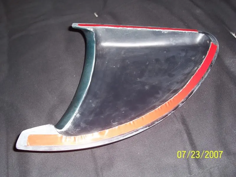

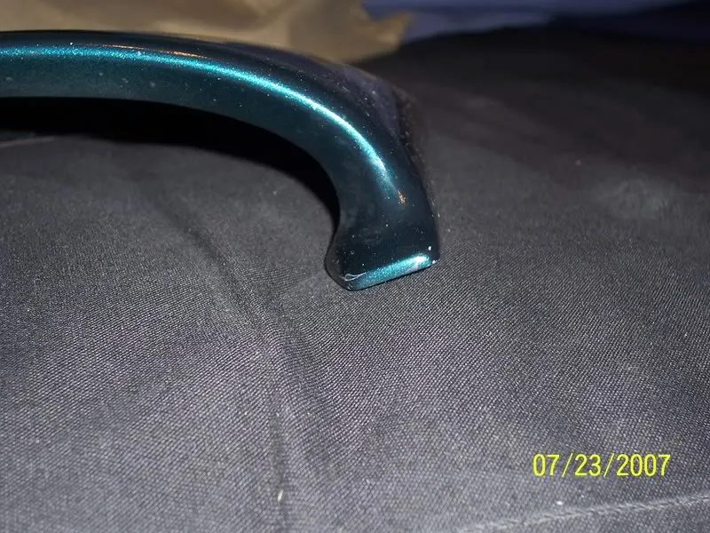

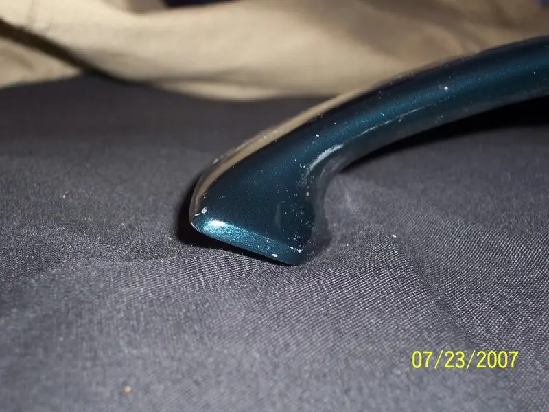

I have one of mine off right now. Ill take some pics for you.
I cant get the back part to stick on right. I need to heat gun it. Its not bad, so Ill take care of it when I get the whole car painted.
lol I love how you can see every single imperfection with the camera.
They are made at an angle so the scoop actually fits like "inside" the stock scoop area.
And these are ABC scoops, from what I can tell, all brands differ some.
TOP
BOTTOM
INSIDE
INSIDE BOTTOM
INSIDE TOP
If you look carefully at the last two pics, you can see that there is a little lip that pretty much tells you where to put the tape.

heres some really crappy pics i took. Its extremely hot outside for me to tinker with it for now. its weird how it was made to fit. i think i'm gonna have to make it fit somehow.

Those are meant to be molded to the body. Id either send them back or practice your fiberglass work and make some lips on it like mine.
