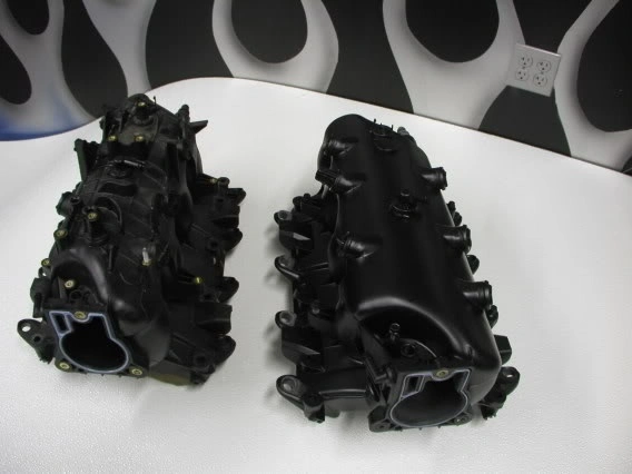

@tannerc91gt Also got confirmation that going to an LS car style intake yields no power gains over the truck. Only benefit is hood clearance. I found that interesting.
It was my understanding that you actually made a little more down low with the truck manifold the issue was just not making as much power passed. 5k? I think yours being boosted negates some of those limitations and if you're still planning to run the truck manifold I'm all for it!
Check out the guys who've stuck with the truck mani's and cleaned them up.
Fwiw, my buddy had an ls in his 78 Chevy farm truck. He used the stock truck manifold a custom cam and stock ported heads. With an 80mm turbo the truck has been 9.0's. He switched to the edelbrock intake and picked up a minimal amount of hp. It looks good but that's about the only difference.
Yeah cam and heads seem to make the most difference, mainly cam though. We will see how this holds up, I will not be dumping more money into this motor at all, period.
