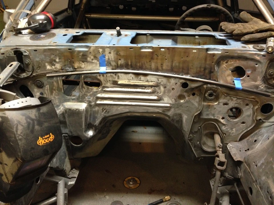

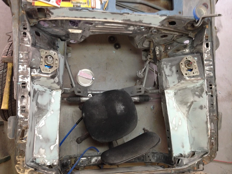

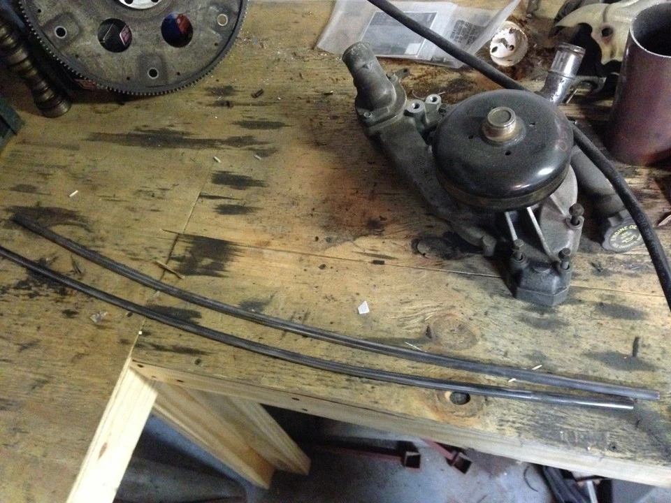

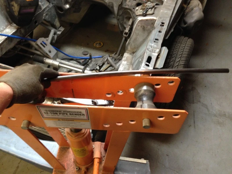

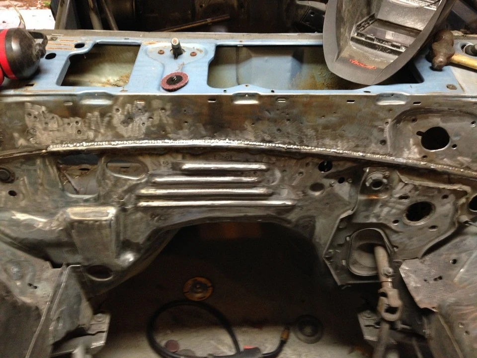

Started with some round tubing and bent it to a gentle curve
Then bent it to match the line of the seam on the fire wall
cut it in half...
and welded it up.

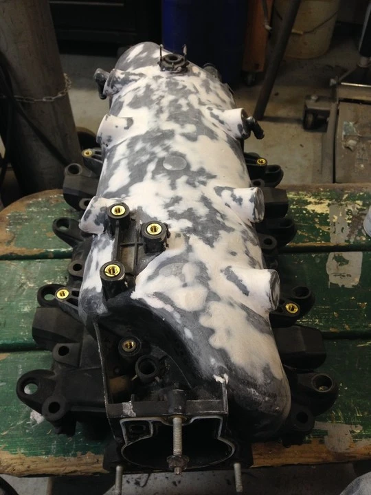

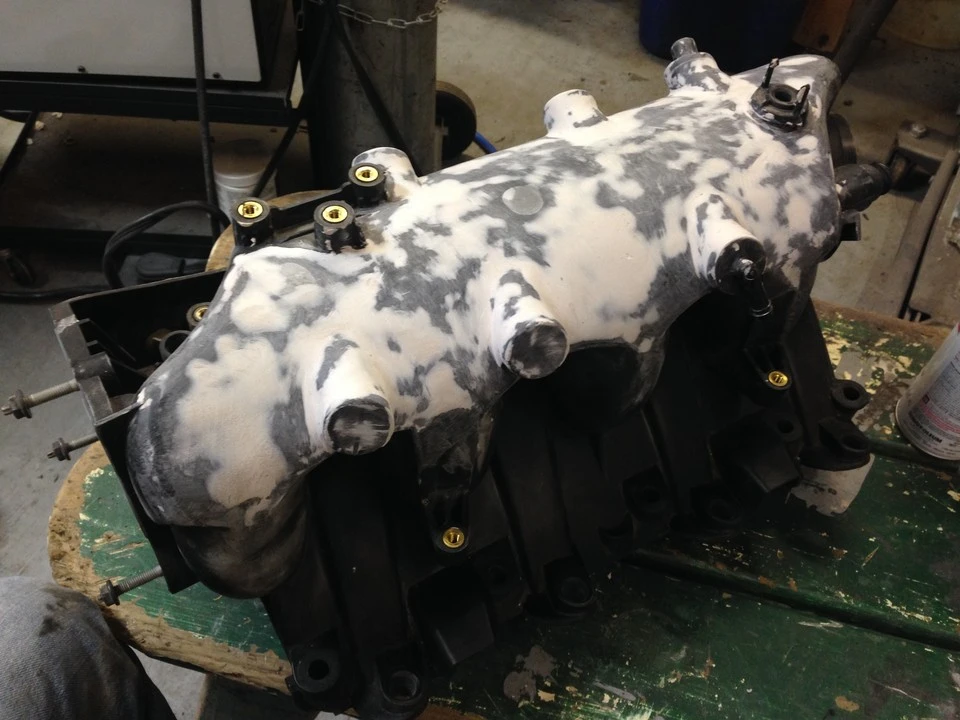

The intake is also coming along. I still have a couple of hours of sanding to do, but it's getting there.
Good job on the save on the firewall. I cut a small section of mine off yesterday, and then thought better of it, and welded it back.

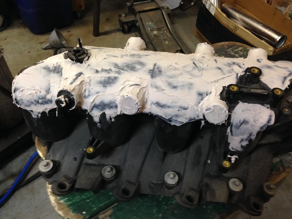

Sanding and Sanding and Sanding and Sanding andSanding andSanding andSanding andSanding andSanding andSanding andSanding andSanding andSanding andSanding andSanding andSanding andSanding andSanding andSanding andSanding andSanding andSanding andSanding andSanding andSanding and.....
This was after the first round of filler and sanding. I've applied another coat and will sand it down this afternoon after I get back from the racetrack. Nostalgia Drags are in town today!!!
I have about another night or two MAX worth of sanding left in me before I say F*** this S*** and spray color in the engine bay and however it looks is what we get. It just isn't getting done and I'm in it about 40 hours from start of welding to now.

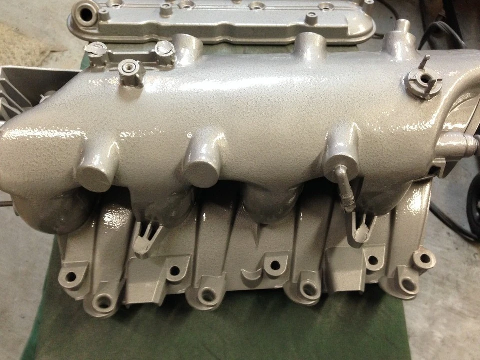

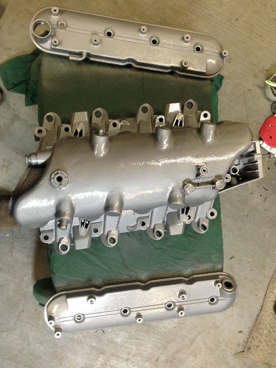

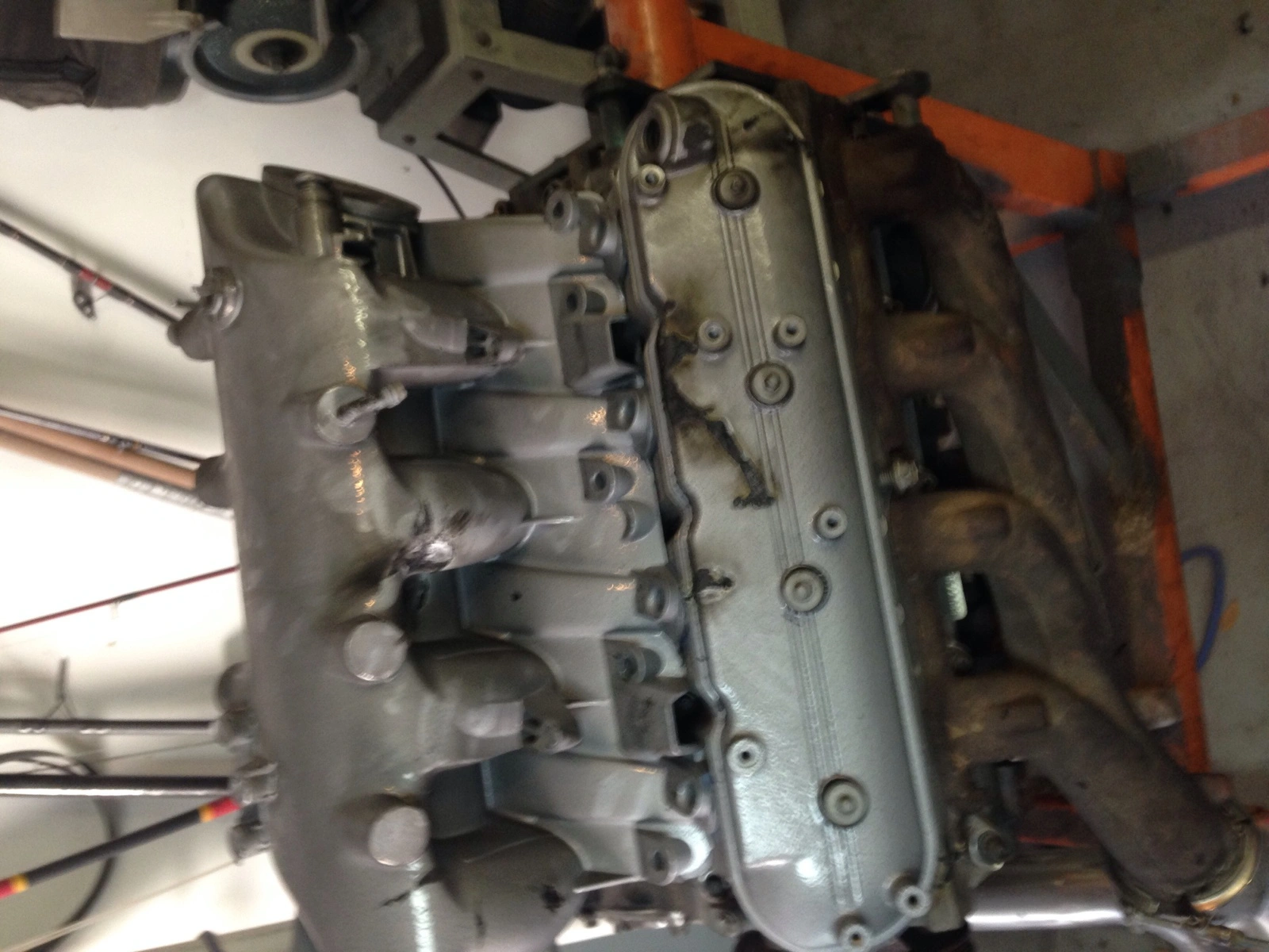

Yep, still sanding. Although yesterday, I was welding on a couple holes I missed and my leg felt hot. I pick up my hood to see the sheet covering the engine in flames.
Gotta repaint the intake and a valve cover now. I have no idea how that happened!!!

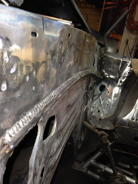

Well, I've opened up a small can of worms. :nonono:
Ya know that lip metal that sticks out from and transverses the entire firewall? The one you always catch your hand on and cuss? That's a body seam, and I decided after a couple of barley pops last night it needed to go. So without completely thinking it through, I cut it off flush with the fire wall. Oops. Turns out that's an intersection of 3 separate pieces of metal, all spot welded together.
So I sat there pondering what to do. I tried welding it back together, but I can't reach everywhere I need to, plus the metal was ground too thin *cough cough oops again*. My next hair brained idea is to go to Home Depot and buy some 1" thin wall tubing, cut it in half long ways and weld it over the seam, heating and bending it as I go to match the contour.
If I can do it correctly, I think it'll look sharp and you'd never notice I did anything. Or it'll be another "I think I'm going to hack the front end of my car off" idea. We shall see...

We've all been there man. You get caulk strong and just start hacking and wacking and then realize you've lept before you looked. Looks like you saved it though.
