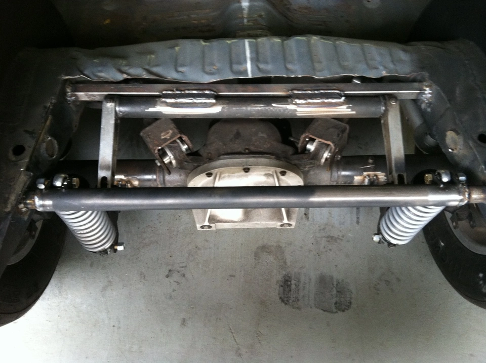

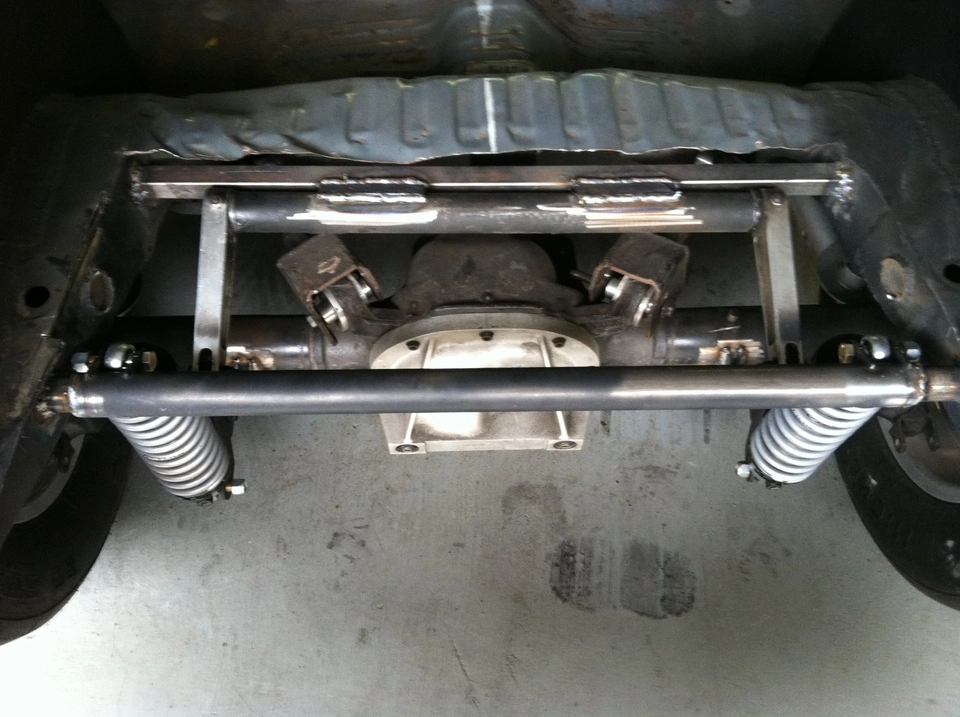

Also, I cut out the shock crossmember in the rear and tacked in the ARB. After narrowing the ARB 3.5" I think it's all going to play together nicely. Hopefully I can get it finished up tomorrow and I'll put up some pictures.

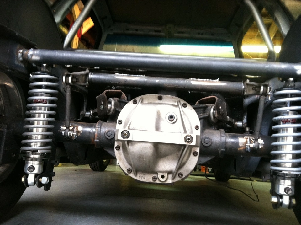

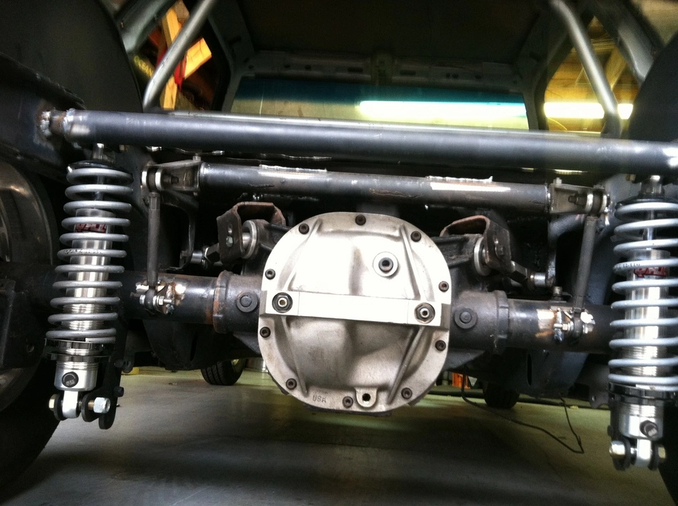

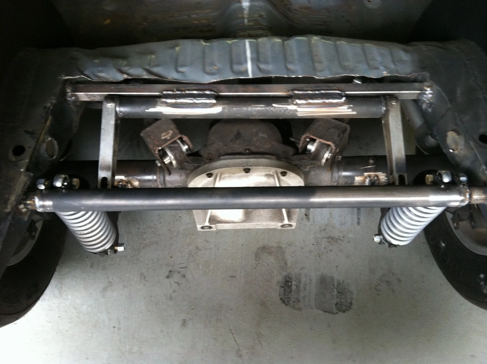

Managed to get the rear suspension 99% done. Have a little bit more welding to do but I ran out of time. Headed to the airport soon and had to pack. I did move the axle through its full range of motion to make sure nothing hits or binds. All looks good!
Next question is should I make the 2 rear bars that run from the main hoop to the back of the car tie into the coil over cross bar? If so, I think I'll just cut out the cage altogether. I know a guy trying to get rid of a Wolfe 10 pt cage for pretty cheap.

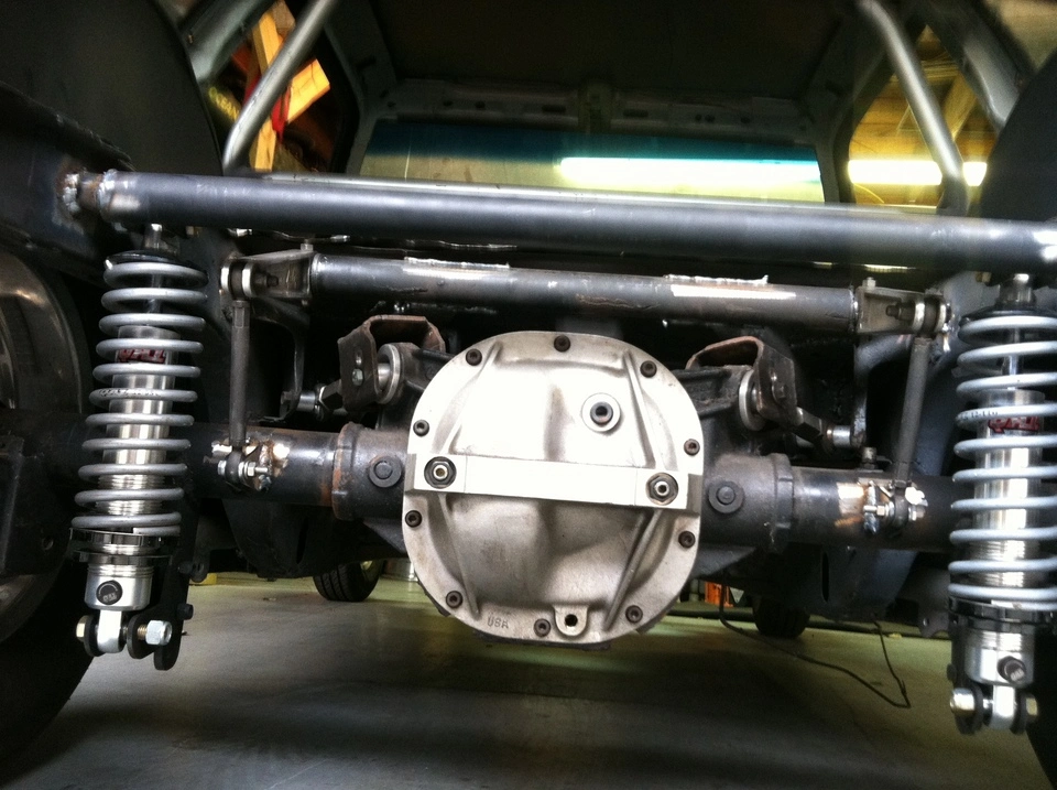

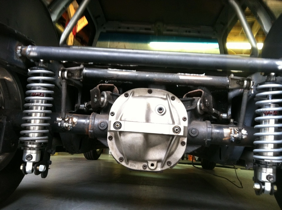

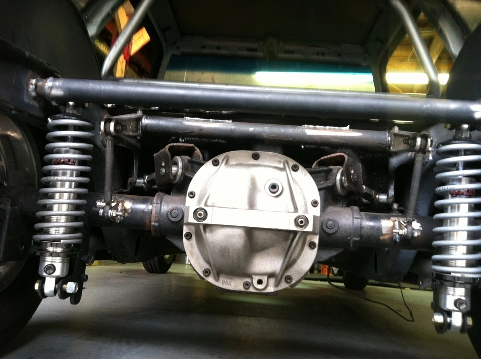

The place I'd tie rear bars into would be the rear frame rails at the rear most point, w/ outriggers tied into the square ARB mount, maybe the C/O cross member for good measure. I'd think that thing ^^would flex.

Looks good. Who's coil overs are you running? Anti roll bar is pretty beefy.
They're single adjustable qa1s. Seem like good pieces, got them lightly used

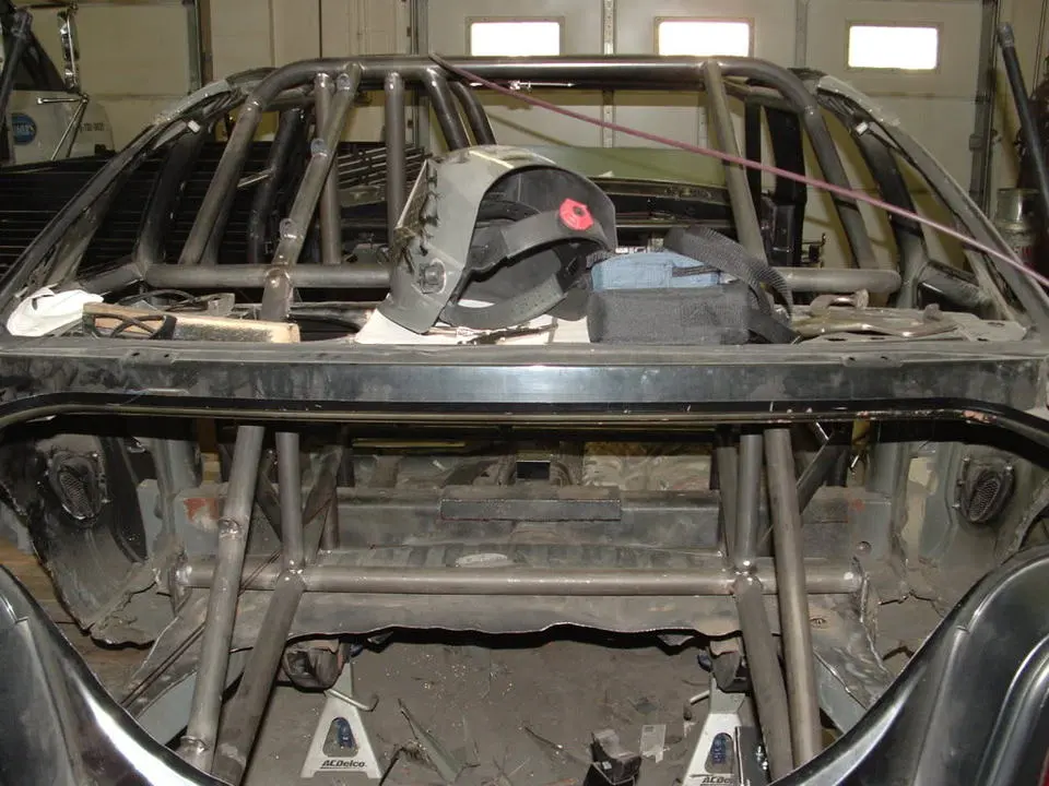

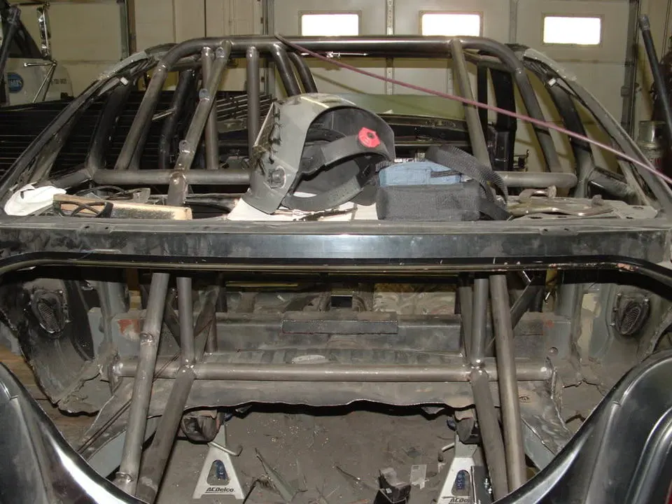

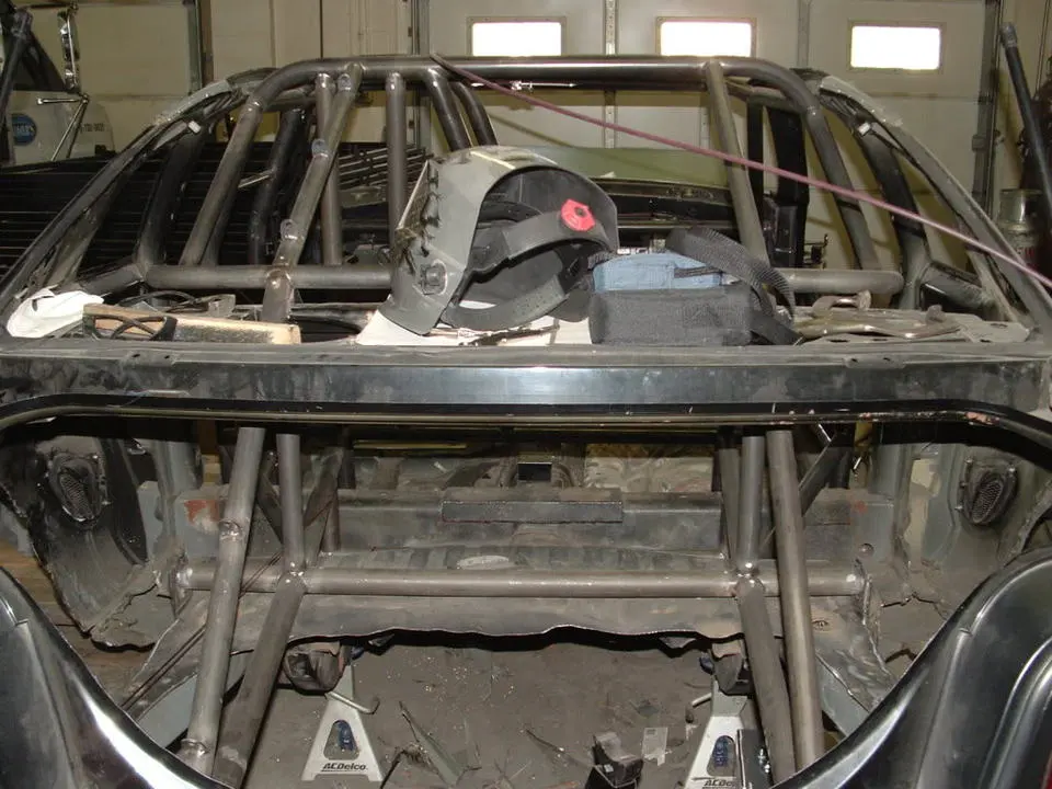

This may have been what MadMike was saying, but yeah, I'd just drop a couple of short bars down from the rear bars down to the coilover mount. I did my 25.5 Saleen like that. Let me look for the pics...
Sorry, this is the closest one I have... but you get the idea
